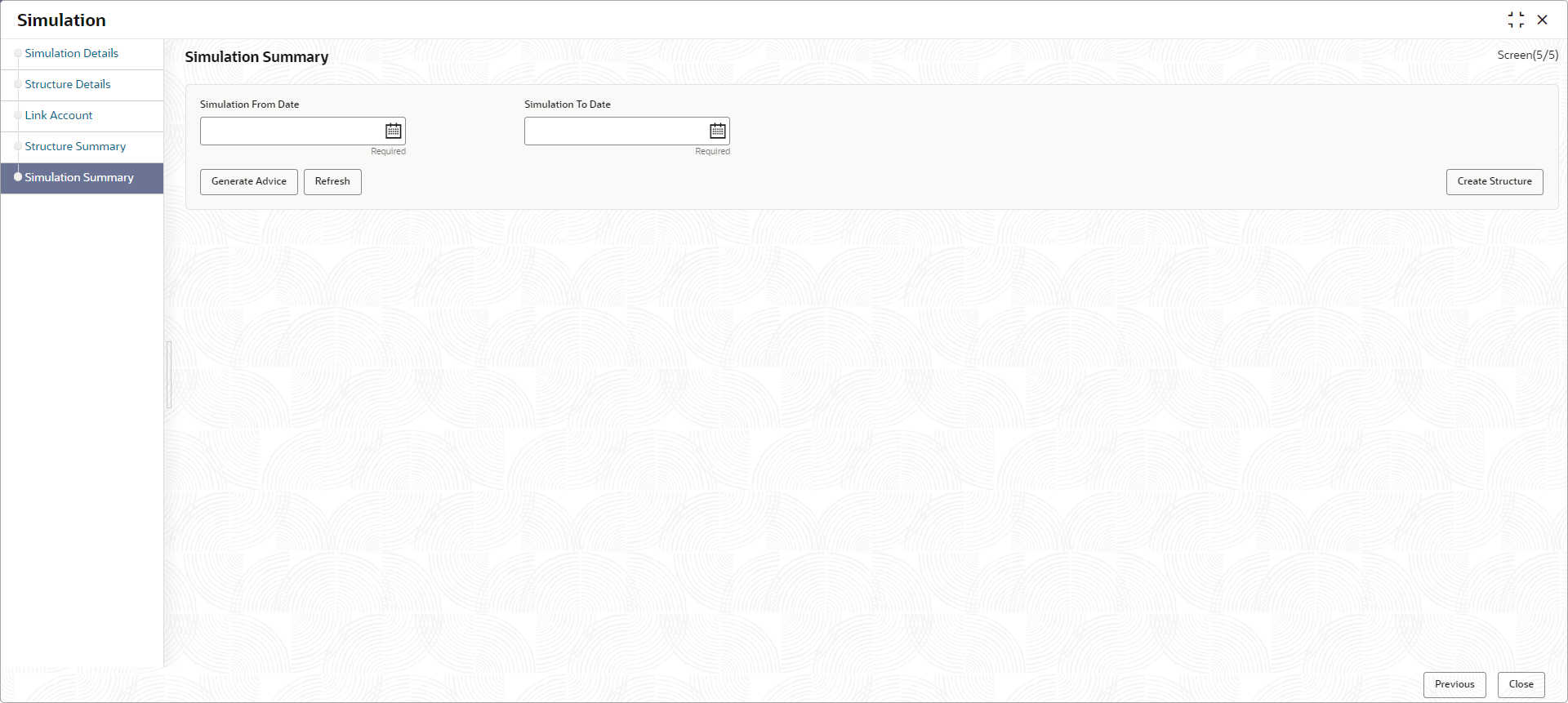

12.1.1.5 Simulation Summary
This topic describes the systematic instructions to simulate the structure for the selected simulation period and calculate the interest.
  1. Click Next button on the Structure Summary screen.
    The Simulation Summary screen displays.
    Figure 12-15 Simulation Summary
  2. Specify the fields on Simulation Summary screen.
    The fields, which are marked with an asterisk, are mandatory.
    Table 12-15 Simulation Summary - Field Description
    Field Description
    Simulation From Date Select the date from when the data has to be simulated.
    Simulation To Date Select the date till when the data has to be simulated.
    This date should be always greater than the From date.
  3. Click Generate Advice to generate the simulation advice.
    Liquidity Management Benefit Advice is generated in PDF format and will have the following details.
    • Interest income earned for the simulation period based on the IC Group mapped.
    • Interest income earned for the simulation period as a part of the structure.
    The user can compare and arrive at the benefit of having the participating accounts in structure.
  4. Click Refresh button to view the status and download report link will be shown.
  5. Click Previous to navigate back to the Structure Summary screen.
  6. Click Close to discard the updated details and close the Simulation screen.
  7. Click Create Structure to convert the simulated structure into an actual structure.
    Once the simulated structure is initiated, the structure goes through the authorization process and on appropriate approval becomes an actual structure.
    The stimulated structure is converted to actual structure only for the existing customers and their accounts.
