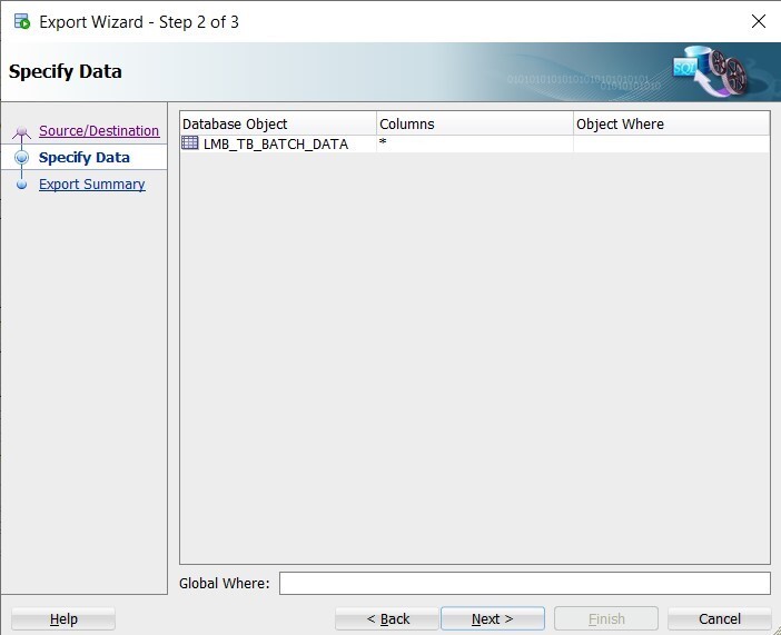

The table that holds the data for the scheduled sweeps has been moved from the schema of batch service to the schema of sweep service.

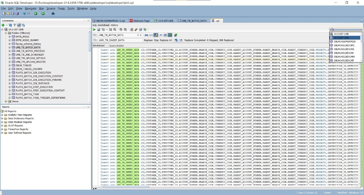

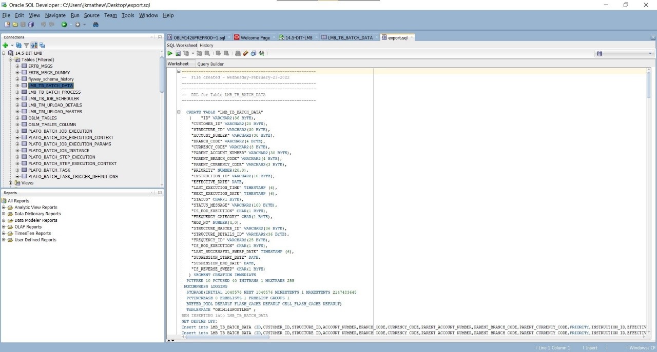

The name of this table is changed from LMB_TB_BATCH_DATA to LMS_TB_SWEEP_DATA. For newly created structures, the data gets saved directly to the new table but for the existing data, migration must be done manually.

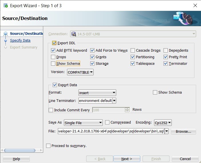

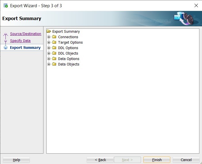

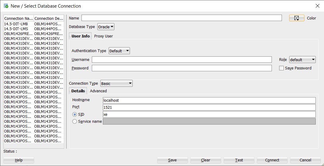

Follow the below steps to manually migrate the data using Oracle SQL Developer.
