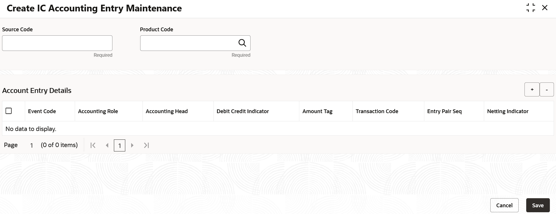

- Under IC Accounting Entry Maintenance, click Create IC Accounting Entry Maintenance. The Create IC Accounting Entry Maintenance screen displays.
Figure 1-16 Create IC Accounting Entry Maintenance
- Specify the fields on Create IC Accounting Entry Maintenance screen.
The fields marked as Required are mandatory.For more information on fields, refer to the field description table.
Table 1-16 Create IC Accounting Entry Maintenance - Field Description
Field Description Source Code Specify the source code of the system. Product Code Click Search icon to view and select the code of the product for which you are defining preferences. The Product maintained in the Product Maintenance screen is available in the LOV list.

Entry Pair Seq Displays the sequence number of the debit and credit pair entry. Netting Indicator Select the toggle to display the netting type. - Click + to add IC account entry details.
- Click - to remove IC account entry details.
- Click Save to save the details.The user can view the configured IC accounting entry maintenance using View IC Accounting Entry Maintenance screen.
