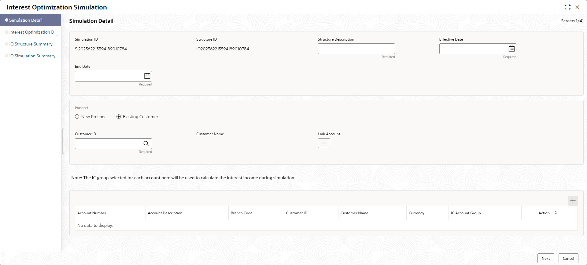

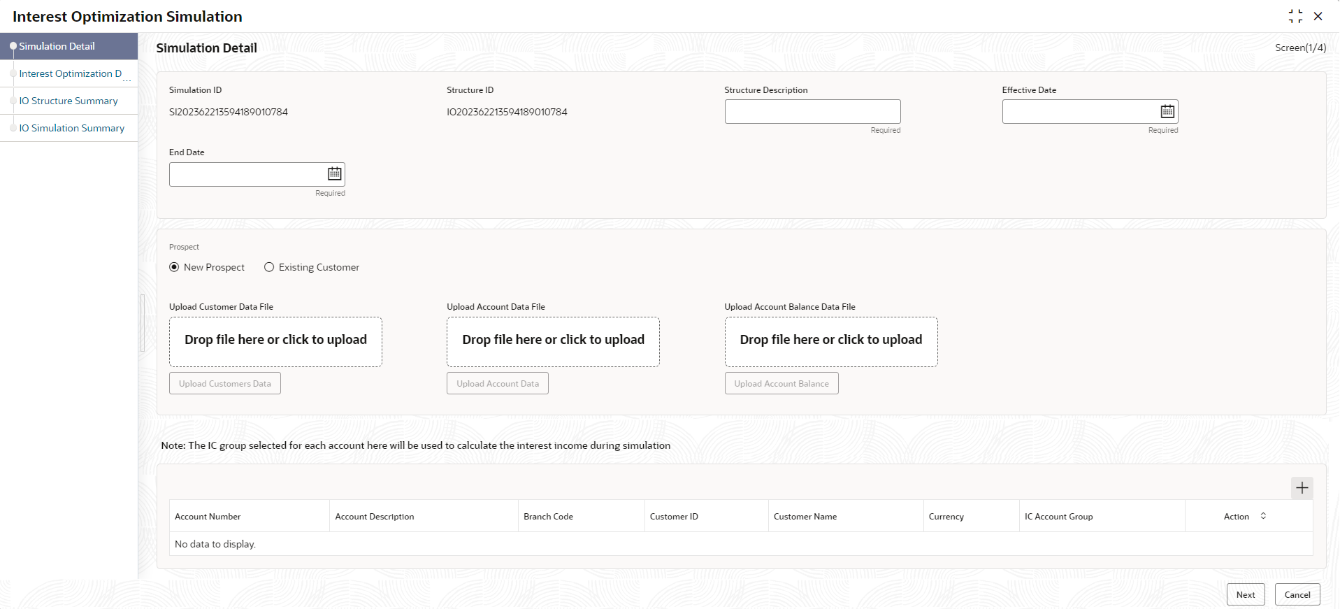

- Click + button on the Interest Optimization
                        Simulation screen.The Interest Optimization Simulation Details screen displays.Figure 11-19 Interest Optimization Simulation Details - New Prospect Figure 11-20 Interest Optimization Simulation Details - Existing Customer
- Specify the fields on Interest Optimization Simulation
                        Details screen.For more information on fields, refer to the field description table.Note: The fields marked as Required are mandatory.Table 11-17 Interest Optimization Simulation Details - Field Description Field Description Simulator ID Displays the simulation ID which is auto generated. Structure ID Displays the structure ID which is auto generated. Effective Date Specify the date from when the simulation structure becomes effective. End Date Specify the date till when the simulation structure is effective. Note: This date should always be greater than the effective date.Prospect Select the type of prospect as New Prospect/ Existing Customer. Drop file or click to upload Click this button to browse and select the file for the respective file uploads. Note: This field is applicable to New Prospect.Upload Customer Data Click this button to upload the customer data file. Note: This field is applicable to New Prospect.Upload Account Data Click this button to upload the account data file. Note: This field is applicable to New Prospect.Upload Account Balance Click this button to upload the account balance data file. Note: This field is applicable to New Prospect.Customer ID Click Search icon to view and select the customer ID from the list. Note: This field is applicable to Existing Customer.Customer Name Displays the name of the customer based on the customer ID selected. Note: This field is applicable to Existing Customer.Account Number Displays the account number. Note: This field is editable.Account Description Displays the account description of the account. Note: This field is editable.Branch Code Displays the branch code for the account. Note: This field is editable.Customer ID Displays the customer ID for the account. Note: This field is editable.Customer Name Displays the customer name for the account. Note: This field is editable.Currency Displays the currency for the account. Note: This field is editable.IC Account Group Click Search icon and select the IC Account Group.
- Click  icon and select the accounts to participate in structure..The Link Account Dialog displays. icon and select the accounts to participate in structure..The Link Account Dialog displays.

- Click OK to add the selected accounts to the Simulation Details screen.
- Click  to add the new for account details. to add the new for account details.
- Click  to edit the account details. to edit the account details.
- Click  to delete the account details. to delete the account details.
- Click Next to save and navigate to the Interest Optimization Detail screen.
- Click Save and Close to save and close the simulation details.
- Click Cancel to discard the changes.
