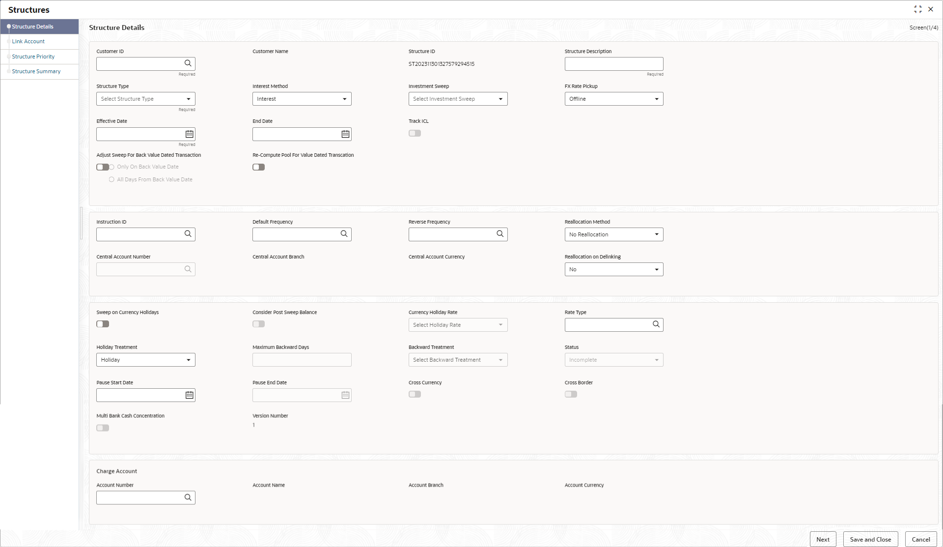

- On Home screen, click Liquidity Management. Under Liquidity Management, click Structure.
- Under Structure, click Account Structure.
- Click + button on the Account
Structure to add a new structure.The Structure Details screen displays.
- Specify the fields on Structure Details screen.
The fields marked as Required are mandatory.For more information on fields, refer to the field description table.
Table 6-2 Structure Details – Field Description
Field Description Customer ID Click Search to view and select the customer ID from the list. The list displays all the customer IDs maintained in the system. Customer Name Displays the customer names based on the Customer ID selected. Structure ID Displays the unique structure ID. Structure Description Specify the description for the new structure. Structure Type Select the type of structure from the drop-down list. The available options are:- Sweep

- Click Next to save and navigate to the next screen (Link Account).
- Click Save and Close. to save and close the details.
- Click Cancel to discard the changes and close the window.
