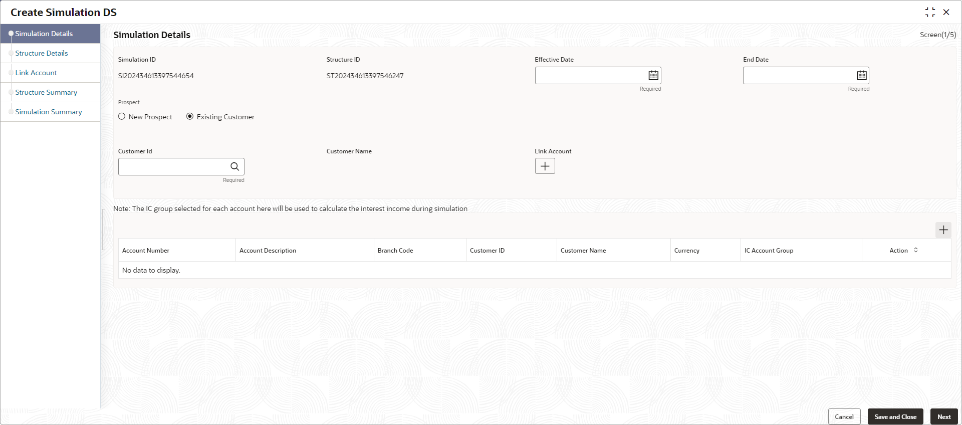

This topic describes the systematic instructions to create the new simulation structure maintained in Oracle Banking Liquidity Management system.
- On Home screen, click Liquidity Management. Under Liquidity Management, click Structure.
 - Under Structure, click Simulation
                        DS. Under Simulation DS, click
                        Create Simulation DS.The Simulation Details screen displays.
Figure 13-1 Simulation Details - New Prospect
Figure 13-2 Simulation Details - Existing Customer
 - Specify the fields on Simulation Details screen.For more information on fields, refer to the field description table.
The fields marked as Required are mandatory.Table 13-1 Simulation Details - Field Description
