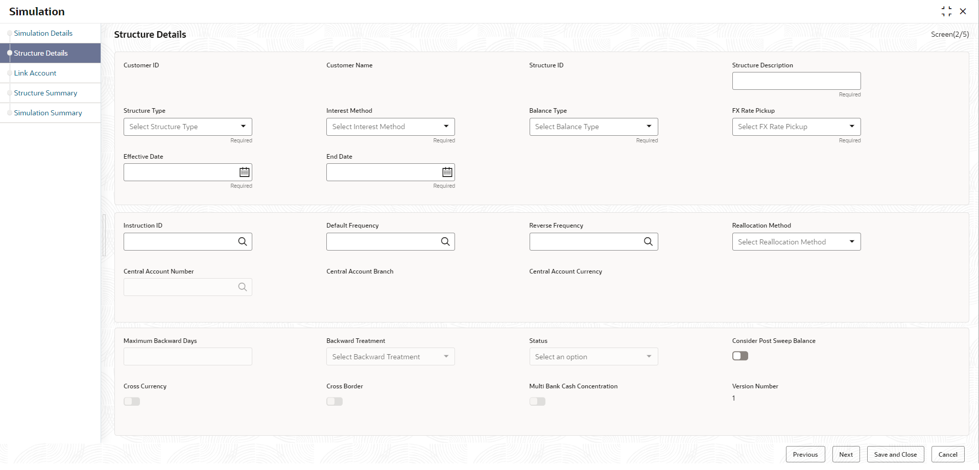

This topic describes the systematic instructions to update the structure details for creating a new structure.
- Click Next in the Simulation
Details screen to update the Structure Details.The Structure Details screen displays.
- Specify the fields on Structure Details screen.
The fields marked as Required are mandatory.For more information on fields, refer to the field description table.
Table 12-4 Structure Details – Field Description
Field Description Customer ID Displays the Customer ID for the exisitng customer Prospect. Customer Name Displays the customer names based on the Customer ID selected. Structure ID Displays the unique structure ID. Structure Description Specify the description for the structure. Structure Type Select the type of structure from the drop-down list. The available options are:- Sweep

Cross Post Sweep Balance This field gets automatically selected on save if the underlying structure is created with accounts which are in different currencies. Cross Currency This field gets automatically selected on save if the underlying structure is created with accounts which are in different currencies. Cross Border This field gets automatically selected on save if the underlying structure is created with accounts which are from two or more different countries. Multi Bank Cash Concentration This field gets automatically selected on save if the underlying structure created has external bank accounts. Version Number Displays the version number of the structure. - Click Next to save and navigate to the next screen (Link Account).
- Click Save and Close. to save and close the details.
- Click Cancel to discard the changes and close the window.
