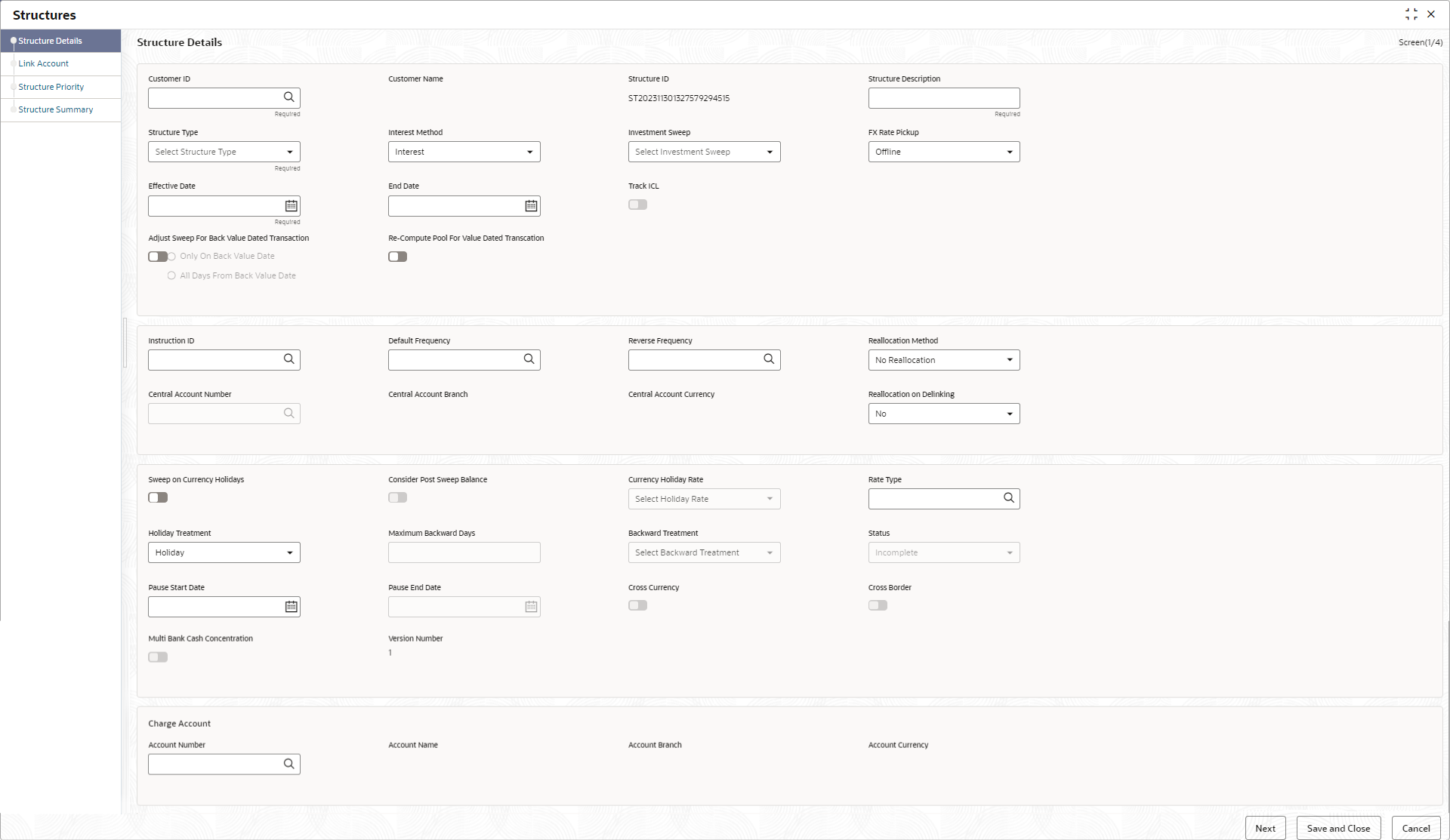

This topic describes the systematic instructions to update the structure details for creating a new structure.
Specify User ID and Password, and login to Home screen.
- On Home screen, click Liquidity Management. Under Liquidity Management, click Structure.
- Under Structure, click Account Structure
DS. Under Account Structure DS, click
Create Account Structure.The Create Account Structure - Structure Details screen displays.
- Specify the fields on Structure Details screen.
The fields marked as Required are mandatory.For more information on fields, refer to the field description table.
Table 7-1 Structure Details – Field Description
Field Description Customer ID Click Search to view and select the customer ID from the list. The list displays all the customer IDs maintained in the system. Customer Name Displays the customer names based on the Customer ID selected. Structure ID Displays the unique structure ID. Structure Description Specify the description for the new structure. Structure Type Select the type of structure from the drop-down list. The available options are:- Sweep

- Click Next to save and navigate to the next screen
(Link Account).
- If the Structure Type is selected as Sweep, then refer to the Link Account for Sweep Structure section.
- If the Structure Type is selected as Pool, then refer to the Link Account for Pool Structure section.
- If the Structure Type is selected as Hybrid, then refer to the Link Account for Hybrid Structure section.
- Click Save and Close. to save and close the details.
- Click Cancel to discard the changes and close the window.
