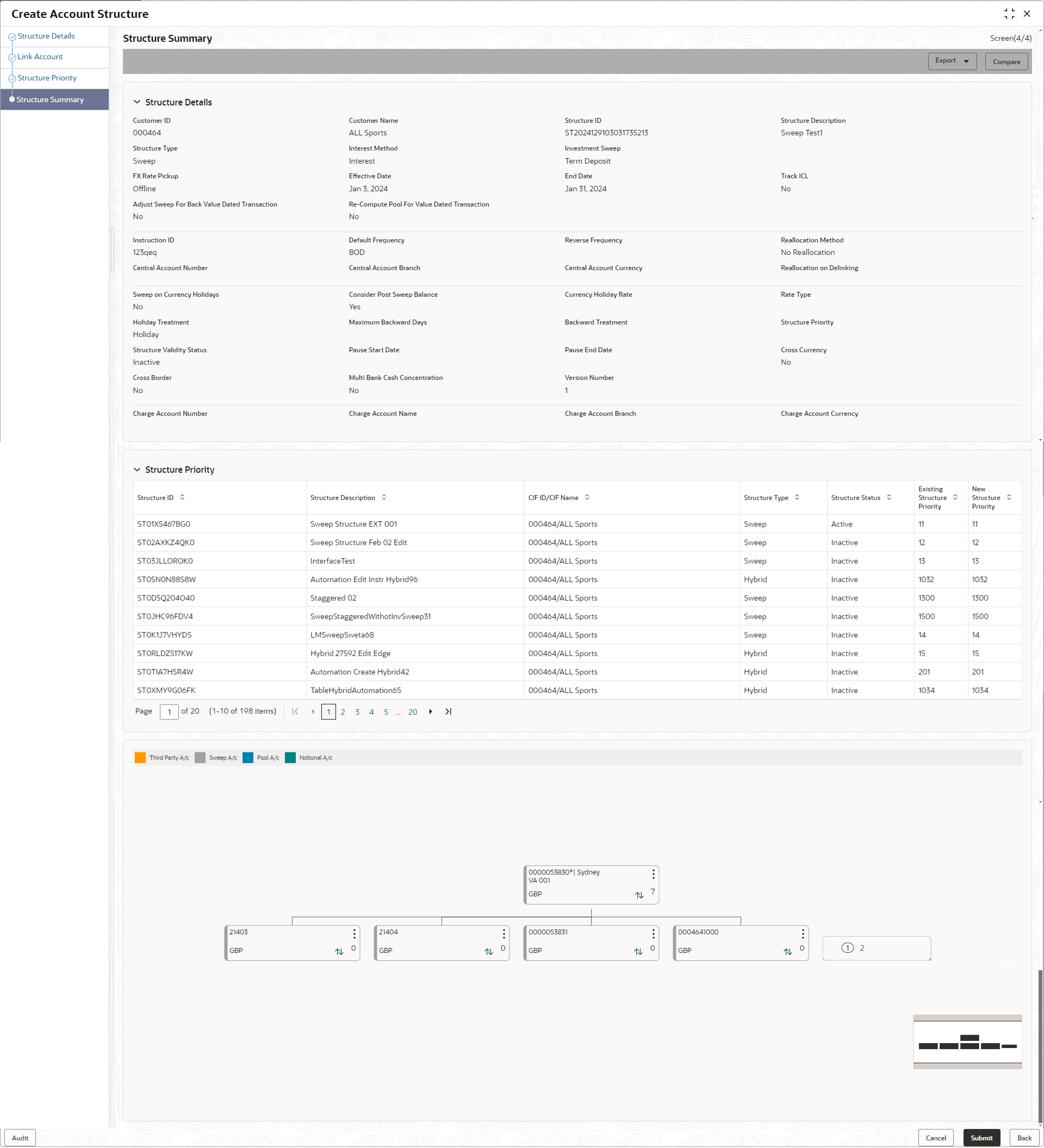

This topic describes the systematic instruction to view the structure details with the tree created.
The Structure Summary screen provides the summary of the structure created or modified. The tree will display unidirectional or bidirectional arrows as per the direction of sweep between the Child and Parent accounts.
               - Click Next in the Link Account screen after successfully capturing the data, to view the summary screen.The Structure Summary screen displays. For more information on fields, refer to the field description table.
Table 7-33 Structure Summary – Field Description
Field Description Customer ID Displays the customer ID. Customer Name Displays the name of the customer. Structure ID Displays the unique structure ID. Structure Description Displays the description for the structure. Structure Type Displays the type of structure. Interest Method Displays the interest method. Investment Sweeps Displays the interest method. This field is available only for sweep structures.

Version Number Displays the version number of the structure. Structure ID Displays the Structure ID associated with the account. Structure Description Displays the description for the structure. CIF ID/CIF Name Displays the CIF ID/CIF name associated with the structure ID. Structure Type Displays the type of the structure. Structure Status Displays the status of the structure. Existing Structure Priority Displays the existing priority number of the structure. New Structure Priority Displays the new priority number of the structure.  - Sweep Structure
 - Select Excel from the Export dropdown list to download the structure details in excel (.xls) format.
 - Select Compare to compare the difference in values.
 - Click Back to navigate to the previous screen (Link Account). In case, the user wants to make some changes before saving the structure.
 - Click Submit to save and submit the structure.The Override Warning message displays if the any of the selected account is marked Regulated Debits as Y.Else, the Confirmation message displays.
Figure 7-44 Warning Message - Regulated Debit
 - Click Cancel to discard the updated details and close the Structure screen. In such case, the structure will not get saved.
