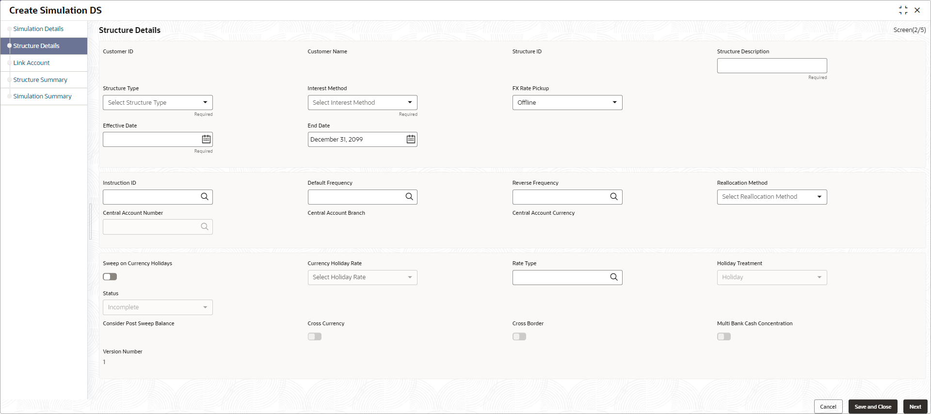

This topic describes the systematic instructions to update the structure details for creating a new structure.
- Click Next in the Simulation
Details screen to update the Structure Details.The Structure Details screen displays.
- Specify the fields on Structure Details screen.
The fields marked as Required are mandatory.For more information on fields, refer to the field description table.
Table 11-3 Structure Details – Field Description
Field Description Customer ID Displays the Customer ID for the exisitng customer Prospect. Customer Name Displays the customer names based on the Customer ID selected. Structure ID Displays the unique structure ID. Structure Description Specify the description for the structure. Structure Type Select the type of structure from the drop-down list. The available options are:- Sweep
