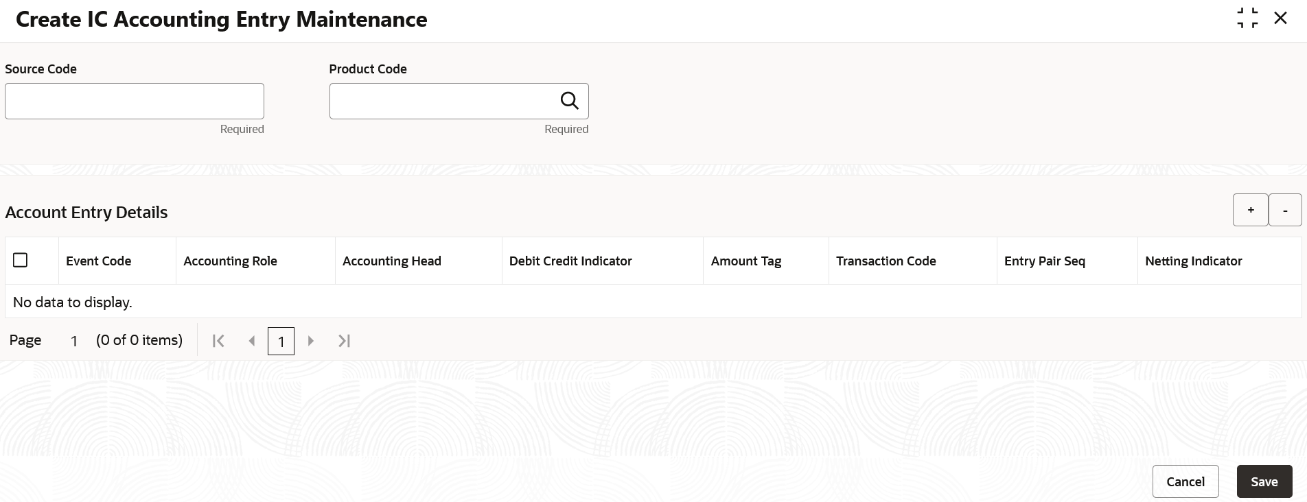

1.5.1 Create IC Accounting Entry Maintenance
This topic describes the systematic instructions to configure the IC accounting entry maintenance details.
  1. On Home screen, click Interest and Charges. Under Interest and Charges, click IC Accounting Entry Maintenance.
  2. Under IC Accounting Entry Maintenance, click Create IC Accounting Entry Maintenance.
    The Create IC Accounting Entry Maintenance screen displays.
    Figure 1-15 Create IC Accounting Entry Maintenance
  3. Specify the fields on Create IC Accounting Entry Maintenance screen.
    The fields marked as Required are mandatory.
    Table 1-14 Create IC Accounting Entry Maintenance - Field Description

  4. Click Save to save the details.
    The user can view the configured IC accounting entry maintenance using View IC Accounting Entry Maintenance screen.
