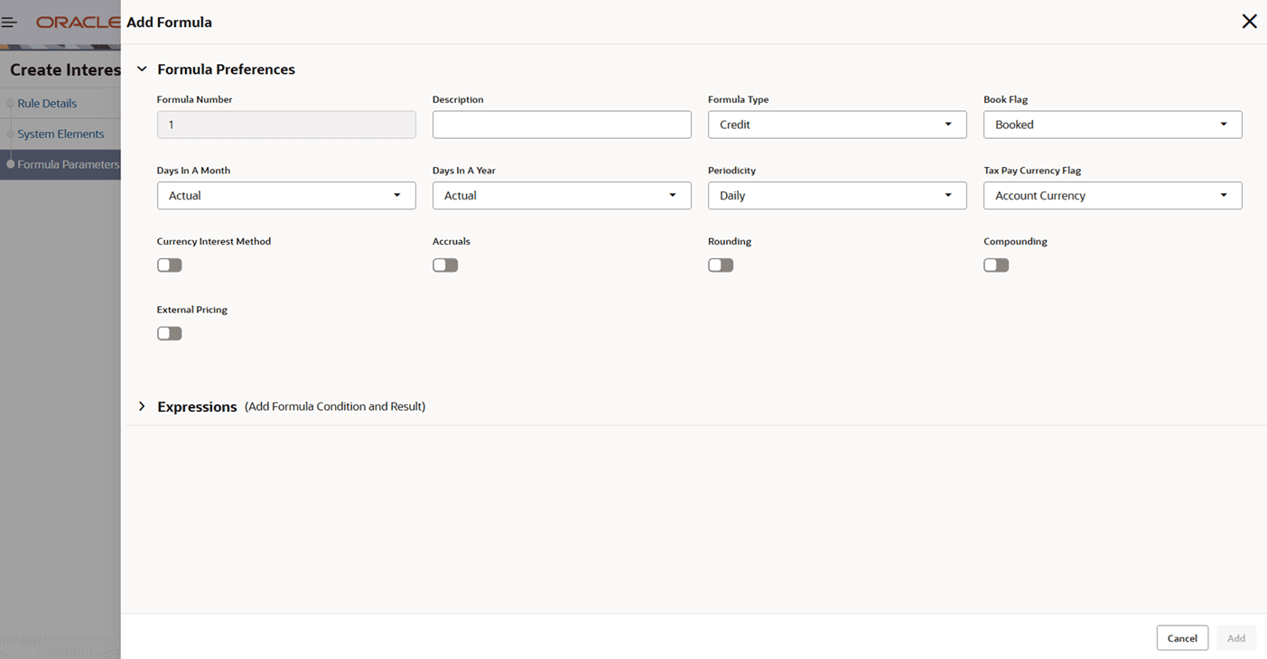

  3. Click Add Formula button.
    The Create Interest Rule - Add Formula - Formula Preferences screen displays.
    Figure 1-8 Create Interest Rule - Add Formula - Formula Preferences
    Table 1-7 Create Interest Rule - Add Formula - Formula Preferences - Field Description
    Field Description
    Formula Number Displays the formula number.
    Description Specify the description of the formula.
    Formula Type Select the formula type from the drop-down list.
    You have to specify the method for calculating interest in the form of formulae.
    The result of a formula will be an amount that has to be either debited from the customer account or credited to it. For example, the debit interest that the user charge on an overdraft would be debited from the customer account; while the credit interest that the user pay would be credited to the customer account. In this screen, you indicate this. Often, when calculating interest for an account, the user would want to debit interest under certain conditions and, under certain other conditions, credit interest. In such a case, the user can build formulae to suit both conditions. The formula that is used to calculate interest for the account would depend on the condition that is fulfilled.
    Book Flag The Booking Flag of a formula denotes whether the result of a formula should be:
    • Booked (that is, if the resulting amount should be posted to the customer account).
    • Non-booked (that is, the result of the formula is to be used in another formula and not to be posted to the customer account).
    • Tax (that is, the formula is used to calculate tax. The tax can be borne either by the customer or the bank).
    Days In A Month The method in which the N of the formula for interest calculation, PNR/100, has to be picked up is specified for a formula. This is done through two fields:
    • Days in a month
    • Days in a year
    The number of interest days for an account can be arrived at in three ways.
    One, by considering:
    • one by considering the actual number of days in a month
    • two, the US method of considering 360 days in a year 3-8
    • three, the Euro method of considering 360 days in a year
    Days In A Year The interest rate is always taken to be quoted per annum. You must therefore indicate the denominator value (the total number of days in the year) based on which interest has to be applied. You can specify the days in a year as
    • Actual number of days (leap year will be 366, non-leap year will be 365)
    • 360 days
    • 365 days (leap and non-leap will be 365)
    Periodicity The Periodicity of a rule application denotes whether the formula you are defining has to be:
    • applied for each change during the interest period (or daily).
    • only for the last day of interest period (periodic).
    Tax Pay Currency Flag Select the currency in which tax is paid. It can be Account currency or Local currency.
    Currency Interest Method Currency method is defaulted from currency definition screen.
    Accruals Select the toggle to enable the interest accruals. Only if you indicate that interest should be accrued (for a formula) will it be done. You can opt to accrue the interest due to one formula and choose not to accrue the interest due to another formula that you are defining for the same rule.
    Note: Only a booking formula can have accruals.
    Rounding Select the toggle to enable the interest rounding.
    Compounding Select the toggle to enable the compounding.
    External Pricing Select the toggle to enable the External Pricing.
Formula Window:
