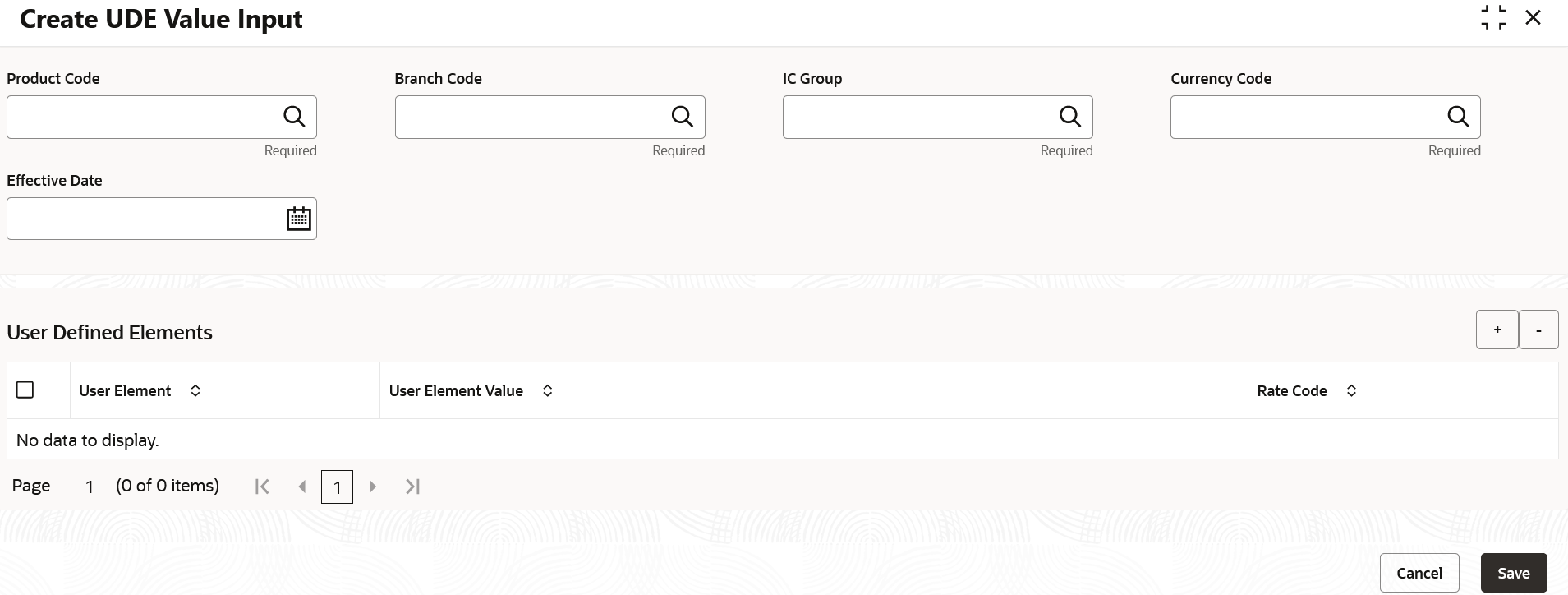

    The Create UDE Value Input screen displays.
    Figure 1-27 Create UDE Value Input
  3. Specify the fields on Create UDE Value Input screen.
    The fields marked as Required are mandatory.
    Table 1-26 Create UDE Value Input - Field Description
