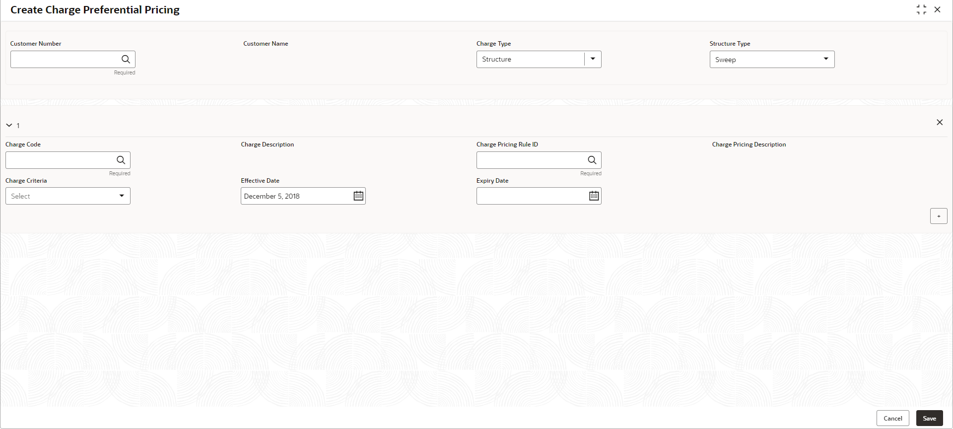

- Under Charge Preferential Pricing, click Create Charge Preferential Pricing.The Create Charge Preferential Pricing screen displays.
Figure 17-9 Create Charge Preferential Pricing
- On Create Charge Preferential Pricing screen, specify the fields. For more information on fields, refer to the field description table.
The fields marked as Required are mandatory.Table 17-14 Create Charge Preferential Pricing - Field Description
Field Description Customer ID Click Search icon to view and select the customer for which the preferential pricing has to be setup. Customer Name Displays the customer name based on selected customer ID. Charge Type Select the type of the charge. The available options are- Customer
- Structure
Structure Type Select the type of the structure. The available options are- Sweep
- Hybrid
- Pool
Charge Code Click Search icon to view and select the charge code for preferential pricing configuration. Note: The charge code will be listed based on the Charge type and for which the active charge decisioning exists.
Charge Code Description Displays the description of the selected charge code. Charge Pricing Rule ID Click Search icon to view and select the charge pricing to be applied. Charge Pricing Description Displays the description of the selected Charge Pricing Rule. Charge Criteria Select the criteria to be considered based on which the charges are calculated. The available options are- One Time Setup Charge
- Structure Setup Charge
- Count of Accounts
- Count of Sweeps
- Flat Maintenance Charge
- Parent Charge Code
Note: The taxes will be applicable based on the tax configured for the charge code in charge decisioning.
Effective Date Select the date from when the preferential pricing validity is effective. Expiry Date Select the date from when the preferential pricing validity is effective. Note:
Any modifications to the preferential charge decisioning will be applied immediately. For example, if the charge decisioning is modified in middle of a charge cycle, on the charge calculation date, the updated charge decisioning will be applied for the entire current charge cycle for calculation purpose.Note:
Charge Configurations, calculations and postings will be at a parent customer level only. - Click Save to save the details.
