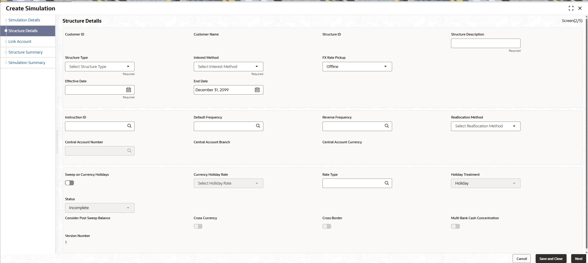

11.1.2 Structure Details
This topic describes the systematic instructions to update the structure details for creating a new structure.
- Click Next in the Simulation
Details screen to update the Structure Details.The Structure Details screen displays.
- Specify the fields on Structure Details screen.
The fields marked as Required are mandatory.For more information on fields, refer to the field description table.
