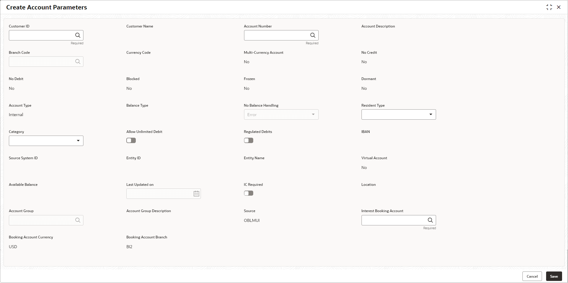

  1. On Home screen, click Liquidity Management. Under Liquidity Management, click Maintenance.
  2. Under Maintenance, click Account Parameters. Under Account Parameters, click Create Account Parameters.
    The Create Account Parameters screen displays.
    Figure 5-3 Create Account Parameters
  3. Specify the fields on Create Account Parameters screen.
    The fields marked as Required are mandatory.

    Added account must be authorized by the different user which has the authorization role assigned.
  4. Click Save to save the details.
