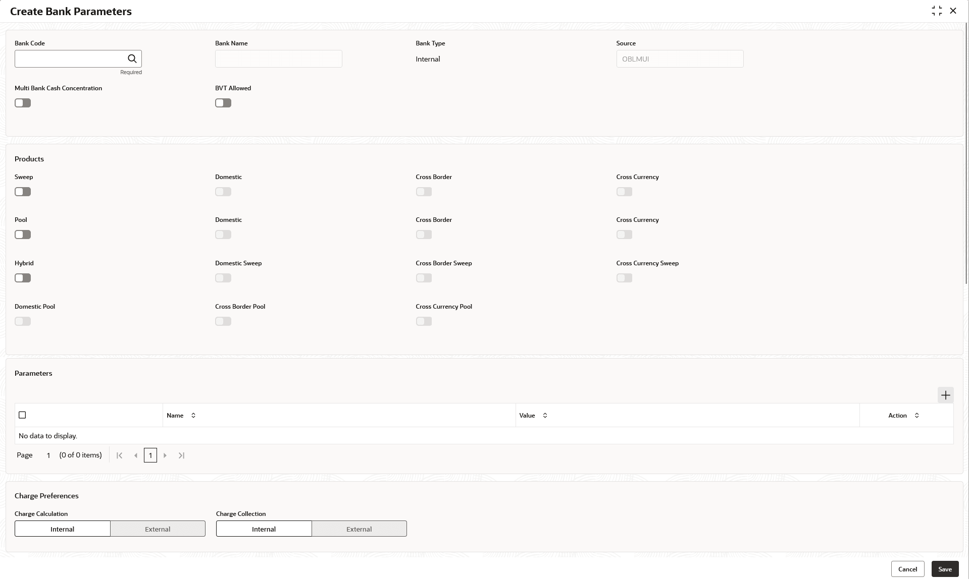

  1. On Home screen, click Liquidity Management. Under Liquidity Management, click Maintenance.
  2. Under Maintenance, click Bank Parameters. Under Bank Parameters, click Create Bank Parameters.
    The Create Bank Parameters screen displays.
    Figure 5-10 Create Bank Parameters
  3. Specify the fields on Create Bank Parameters screen.
    The fields marked as Required are mandatory.

  4. Click Add in the Parameters section to add name and its value.
  5. Click Delete icon to remove a row.
  6. Click Save to save the details.
