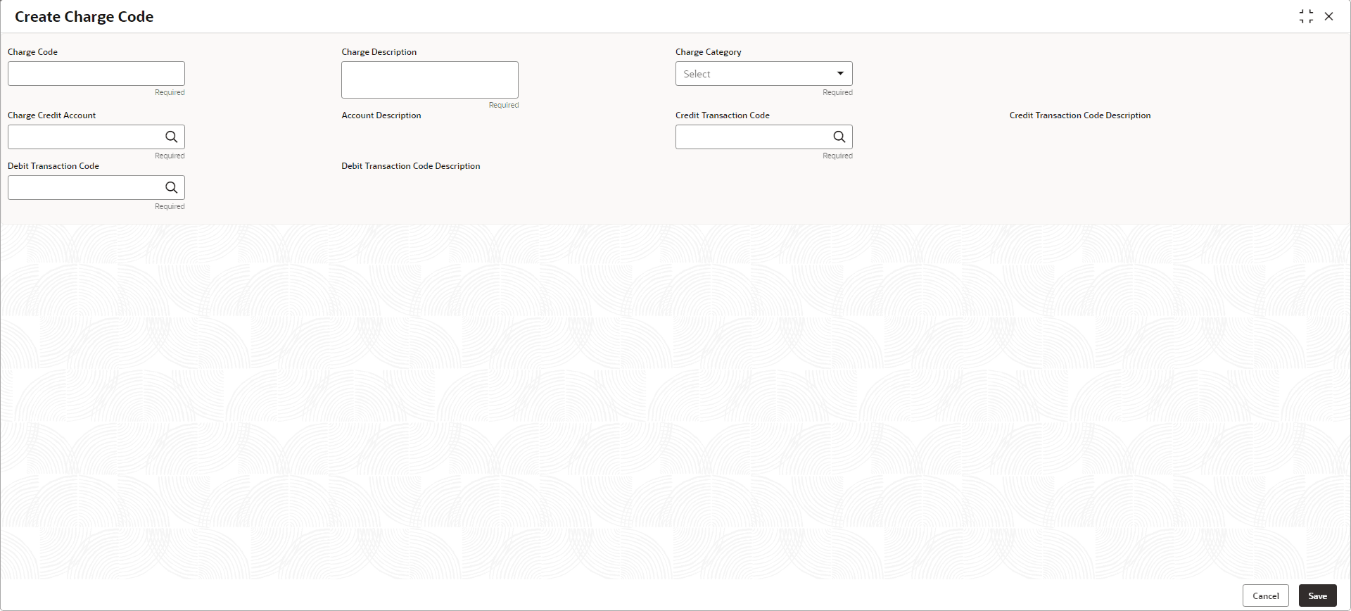

    The Create Charge Code screen displays.
  4. On Create Charge Code screen, specify the fields.
    The fields marked as Required are mandatory.
    Table 17-4 Create Charge Code - Field Description
    Field Description
    Charge Code Specify the unique ID to identify the charge code.
    Charge Description Specify the description of the charge code.
    Charge Category Select the charge category. The available options are:
    • Tax
    • Standard
    Charge Credit Account Click Search icon to view and select the GL account number.
    Account Description Displays the description of the GL account number.
    Credit Transaction Code Click Search icon to view and select the transaction code to be used for Credit leg of charge posting.
    Credit Transaction Code Description Displays the description of the transaction code for Credit leg.
    Debit Transaction Code Click Search icon to view and select the transaction code to be used for Debit leg of charge posting.
    Debit Transaction Code Description Displays the description of the transaction code for Debit leg.
