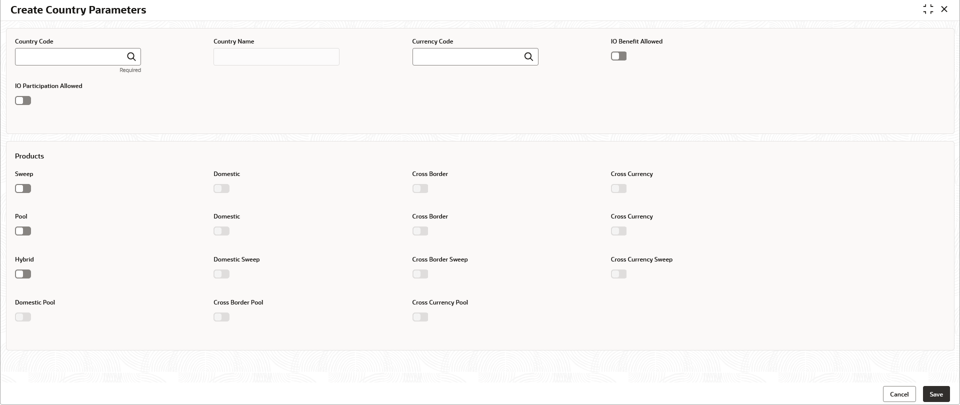

  1. On Home screen, click Liquidity Management. Under Liquidity Management, click Maintenance.
  2. Under Maintenance, click Country Parameters. Under Country Parameters, click Create Country Parameters.
    The Create Country Parameters screen displays.
    Figure 5-13 Create Country Parameters
  3. Specify the fields on Create Country Parameters screen.
    The fields marked as Required are mandatory.
    Table 5-16 Create Country Parameters – Field Description
    Field Description
    Country Code Click Search to view and select the country code.
    The details are fetched from common core maintenance.
    Country Name Specify the name of the currency.
    Currency Code Click Search to view and select the currency code.
    IO Benefit Allowed Switch on the toggle to allow Interest Optimization benefit for this currency
    IO Participation Allowed Switch on the toggle to allow Interest Optimization participation for this currency.
    Products Select the type of products allowed for the Country.
    The available options are:
    • Sweep
    • Pool
    • Hybrid
    Note: The system allows the changes of a product parameter from No to Yes, if the same us set to yes at the Application parameter level.
    Sweep Switch on the toggle to select domestic/cross border/cross currency in sweep structures.
    Domestic Switch on the toggle if the country allows the Domestic accounts to participate in sweep structures.
    Cross Border Switch on the toggle, if the country allows Cross Border accounts in sweep structures.
    Cross Currency Switch on the toggle, if the country allows Cross Currency accounts in sweep structures.
    Pool Switch on the toggle to select domestic/cross border/cross currency in pool structures.
    Domestic Switch on the toggle, if the country allows Domestic accounts in pool structures.
    Cross Border Switch on the toggle, if the country allows Cross Border accounts in pool structures.
    Cross Currency Switch on the toggle, if the country allows Cross Currency accounts in pool structures.
    Hybrid Switch on the toggle to select domestic/cross border/cross currency in Hybrid (Combination of Sweep and Pool) structures.
    Hybrid related flags are enabled only if both Sweep and Pool structure flags are switched on.
    Domestic Sweep Switch on the, toggle if the country allows Domestic sweep accounts in hybrid structures.
    Cross Border Sweep Switch on the toggle, if the country allows Cross Border sweep accounts in hybrid structures.
    Cross Currency Sweep Switch on the toggle, if the country allows Cross Currency sweep accounts in hybrid structures.
    Domestic Pool Switch on the toggle, if the country allows Domestic pool accounts in hybrid structures.
    Cross Border Pool Switch on the toggle, if the country allows Cross Border pool accounts in hybrid structures.
    Cross Currency Pool Switch on the toggle, if the country allows Cross Currency pool accounts in hybrid structures.
  4. Click Save to save the details.
