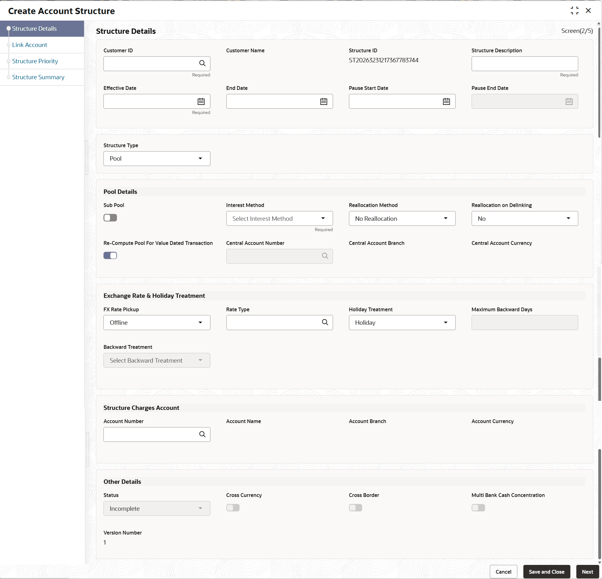

  1. On the Create Account Structure - Structure Details screen, specify the fields.
    The Create Account Structure - Structure Details screen displays.
    Figure 6-16 Create Account Structure - Structure Details - Pool
  2. Select the Pool option from the Structure Type drop-down list.
    The fields marked as Required are mandatory.
    Table 6-13 Structure Details - Pool – Field Description
    Field Description
    Structure Details This section displays the Structure Details fields.
    Customer ID Click Search to view and select the customer ID from the list. The list displays all the customer IDs maintained in the system.
    Customer Name Displays the customer names based on the Customer ID selected.
    Structure ID Displays the unique structure ID.
    Structure Description Specify the description for the new structure.
    Effective Date Select the date from when the structure becomes effective.
    Note: This date cannot be less than the system date but can be a future date.
    End Date Select the date till when the structure is effective.
    Note: This date should always be greater than the effective date.
    Pause Start Date Select the date from when the structure gets paused.
    Note: This field can be a future date but should not be less than the system date.
    Pause End Date Select the date till when the structure gets paused. .
    Structure Type Select the type of structure from the drop-down list.
    The available options are:
    • Sweep
    • Pool
    • Hybrid
    Pool Details This section displays the Pool Details fields.
    Sub Pool Switch the toggle on to add the notional headers of already created and authorized pools as sub pools or the child account to the current pool structure.
    This field is enabled if the user selects the structure type as Pool.
    Interest Method Select the interest method for the structure from the drop-down list.
    • Interest
    • Advantage
    • Ratio
    Note: This field is editable only for Pool Structures. For Sweep and Hybrid Structures, it is automatically populated to Interest Method.
    Reallocation Method Select the reallocation method from the drop-down list. This option refers to the method in which the interest is shared with the participating account entities.
    • Sweep Structure
      • No Reallocation - No interest is paid back to the child accounts.
    • Pool Structure
      • Central Distribution - The interest arrived is credited to one central account, which can be any one of the participating accounts or a separate account.
      • Even Distribution - The interest is evenly distributed among the participating accounts.
      • Even Direct Distribution - The interest reward is evenly spread across all accounts with positive balances.
      • Percentage Based Distribution - The pre-defined percentage of the interest is distributed among the participating accounts. Note: This option is applicable only at the pair level.
      • Fair Share Distribution - If the interest is positive, it is distributed among the positive contributors in the ratio of their contribution. If the interest is negative, it is distributed among the negative contributors in the ratio of their contribution.
      • Reverse Fair Share Distribution - If the interest is positive, it is distributed among the negative contributors in the ratio of their contribution. If the interest is negative, it is distributed among the positive contributors in the ratio of their contribution.
      • Absolute Pro-Rata Distribution - Absolute balances of all accounts are considered and the interest would be shared proportionally to all accounts.
    Reallocation on Delinking Select the reallocation on de-linking option from the drop-down list.
    • Yes - The system will immediately do the liquidation and reallocation to all the accounts.
    • No - The system will do the liquidation and reallocation as per the normal liquidation cycle.
    Note: This field is active only for Pool (Interest, and Advantage method) and Hybrid (Interest Method) structures.
    Re-Compute Pool For Value Dated Transaction Switch on the toggle to enable the recalculation of interest rate for the BVT transaction.
    Note: This field is applicable only if Structure Type is selected as Pool.
    Central Account Number Click Search icon to view and select the central account number to be applied from the list. The list displays all the accounts maintained in the system.
    This field is editable only if the Reallocation Method is selected as Central Distribution. The interest reallocation for the structure is done to the selected account.
    The reallocation for the main pool would always be Central Distribution if the sub pools are attached.
    Central Account Branch Displays the central account branch.
    Central Account Currency Displays the central account currency.
    Include Drain Pool Switch on the toggle to enable include drain pool.
    This field is only enabled when the structure type is Hybrid. User can add the notional header from an existing pool in the structure, add a sweeps instruction and system would perform sweeps considering the balance of the pool. Along with the notional header, user has to nominate an account from the pool to which the actual debit or credit would be done. While creating the structure user can specify the type of sweeps instructions applicable for this nominated account like ZBA/ Target balance etc. Sweeps would be done from the nominated account of the pool to maintain the pool balance as per the sweeps instructions. For example: If the Target constant is maintained as 10k, system would perform sweeps from the nominated account to maintain the pool balance at 10k.
    Exchange Rate & Holiday Treatment This section displays the Exchange Rate & Holiday Treatment fields.
    FX Rate Pickup Select the FX rate pickup for the structure from the drop-down list.
    • Online: The system needs to integrate with an external system to fetch the rates in an online mode.
    • Offline: This option is selected by default wherein the rate available in the system is used for cross currency calculations.
    Rate Type Click Search to view and select the Rate Type from the list. The list displays all the Rate Type maintained in the system.
    Holiday Treatment Select the type of holiday treatment from the drop-down list.
    The available option are:
    • Next Working Date - Perform the action on the next working day.
    • Previous Working Date - Perform the action on the previous working day.
    • Holiday – Do not perform the sweep and mark it as holiday.
    Maximum Backward Days Specify the maximum number of days the system can go back to execute the structure when the execution day falls on a holiday.
    Note: This field is enabled only if the Holiday Treatment is selected as Previous Working Date.
    Backward Treatment Select the backward treatment to be applied from the drop-down list.
    • Move Forward - The action is performed on the next working day.
    • Holiday - Do not perform the sweep.
    When the Maximum Backward Days set is also falling on a holiday, then the system determines the day on which the action is executed based on the Backward Treatment.
    Structure Charges Account This section displays the Structure Charges Account fields.
    Account Number Click Search to view and select the required account number to collect the charges. The charge account number will be the accounts belonging to the parent customer and linked child customers.
    Account Name Displays the account name based on the account number selected.
    Account Branch Displays the account branch based on the account number selected.
    Account Currency Displays the account currency based on the account number selected.
    Other Details This section displays the Other Details fields.
    Status Displays the current status of the structure and is populated by the system.
    • Active: The structure is complete and is in Active status.
    • Paused: The structure is on temporary hold.
    • Incomplete: The structure is still being created.
    • Expired: The structure is expired.
    • In-Active: The structure is not active and is in operational at a future date.
    Cross Currency This field gets automatically selected on save if the underlying structure is created with accounts which are in different currencies.
    Cross Border This field gets automatically selected on save if the underlying structure is created with accounts which are from two or more different countries.
    Multi Bank Cash Concentration This field gets automatically selected on save if the underlying structure created has external bank accounts.
    Version Number Displays the version number of the structure.

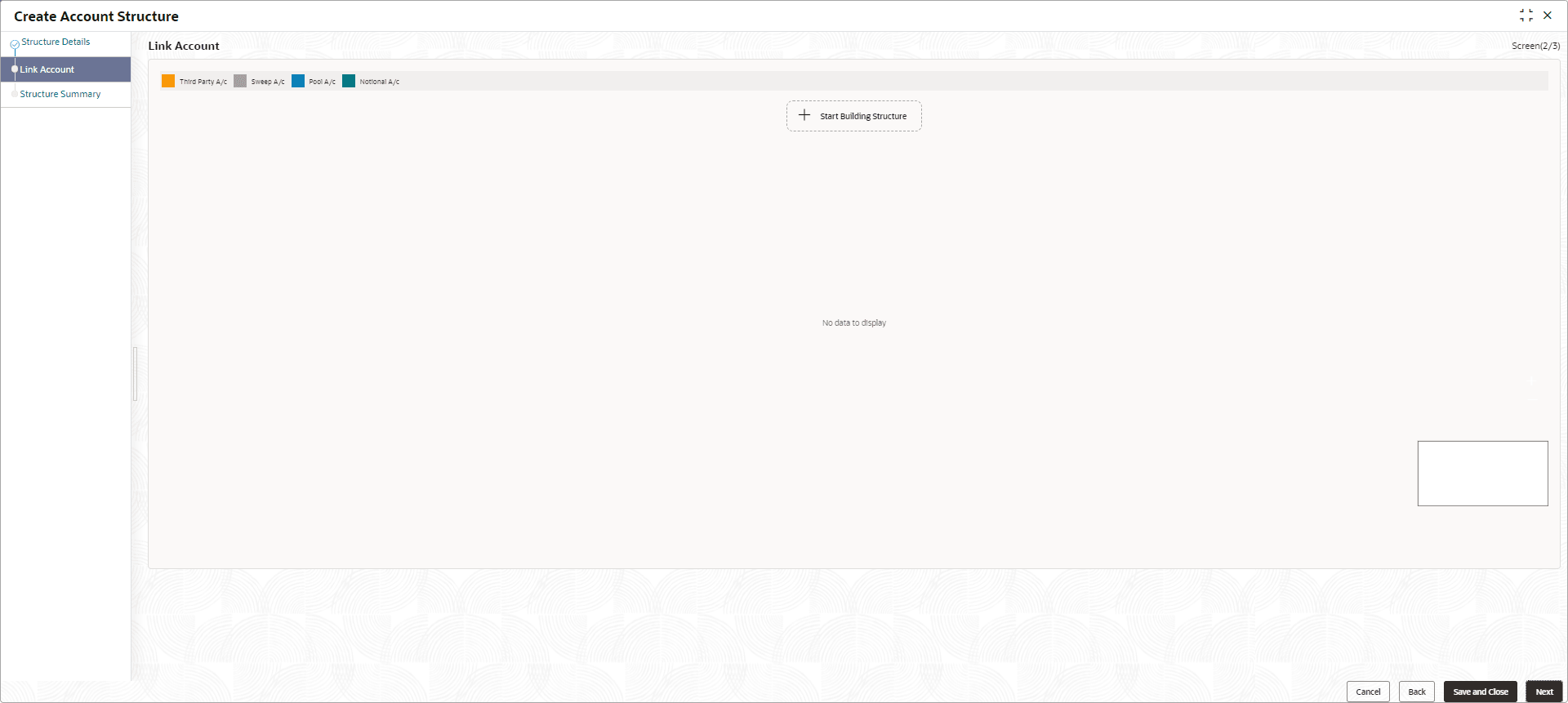

  3. Click Next in the Structure Details screen to link the accounts.
    The Link Account screen displays.
  4. Click Start Building Structure to link the account for the structure.

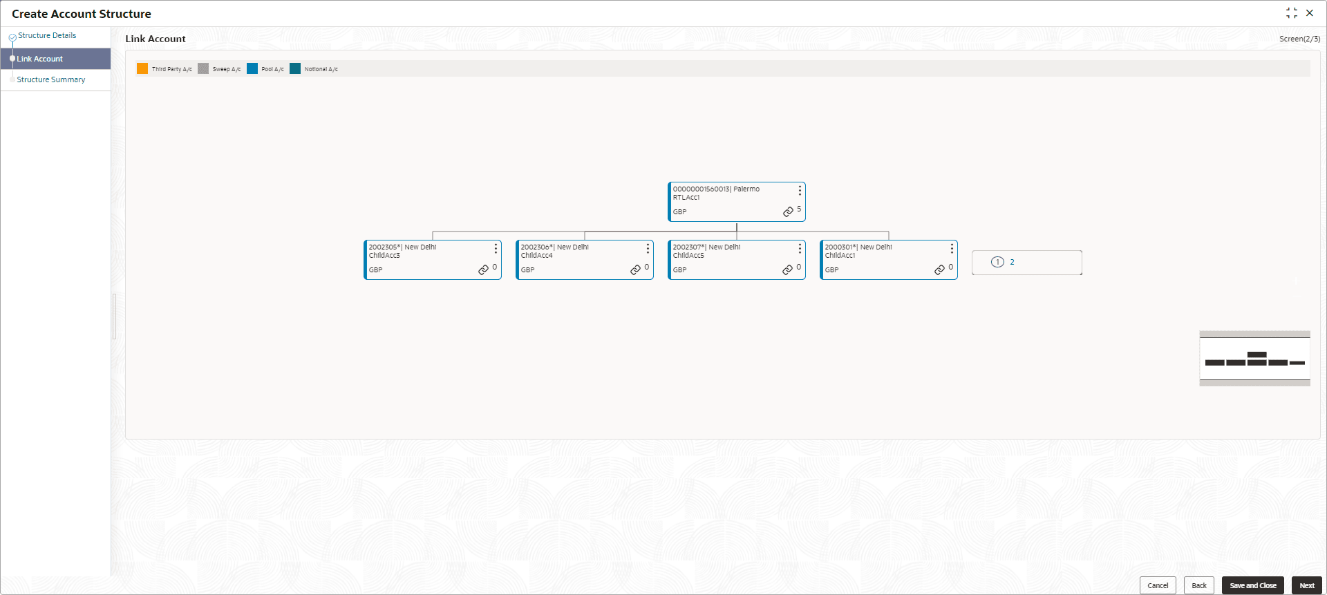

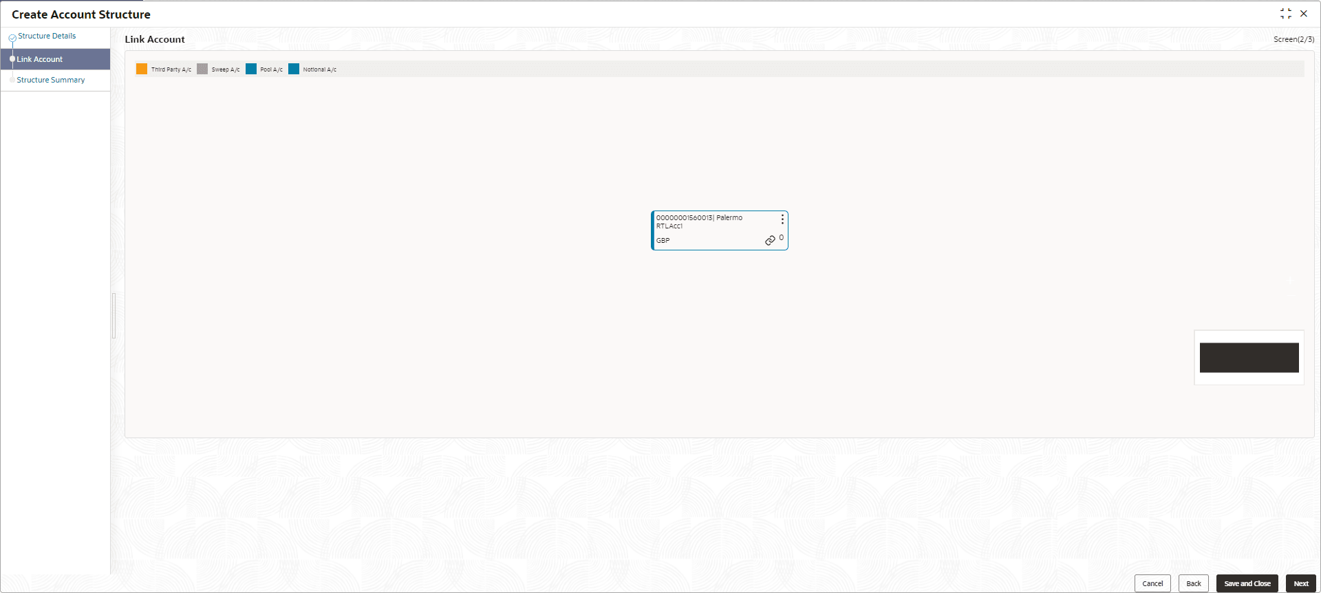

  5. Select the notional account in the Add Header Account screen to add the notional header account.
  6. Click Build to add the selected header account in the Structure.
    The selected account is added to Create Account Structure – Added Header Account screen.
    Figure 6-19 Create Account Structure – Added Header Account

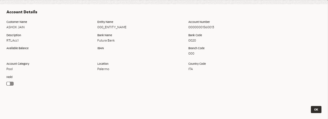

      The Account Details screen displays
      Table 6-16 Account Details - Field Description
      Field Description
      Customer Name Displays the name of the customer.
      Entity Name Displays the name of the entity.
      Account Number Displays the account number.
      Description Displays the description of the particular account.
      Bank Name Displays the bank name in which the account is maintained.
      Note: This field appears only for External Accounts.
      Bank Code Displays the bank code of the account.
      Available Balance Displays the available balance in the account
      IBAN Displays the IBAN number of the account.
      Branch Code Displays the branch code of the account.
      Account Category Displays the category of the account.
      Location Displays the location of the account.
      Country Code Displays the country code for the account
      Hold Select the toggle to enable the hold for the account.
      Hold Start Date Select the hold start date for the account.
      Hold End Date Select the hold end date for the account.

  2. Click Build to add the child accounts to the structure.
    The Create Account Structure - Link Account - View screen displays.
    Figure 6-24 Create Account Structure - Link Account - View
    Only Header node and its immediate child accounts will appear on the screen initially. To view further nodes, click on the respective nodes to expand and view its child accounts. Pagination will be displayed at every level of structure layer and displayed if the number of nodes exceeds the allowed limit as per the configuration
  3. Click Three Dots and then perform anyone of the following actions on the child accounts node.

    2. Click and then click View Account Details to view the account details of the accounts.
      Table 6-20 Account Details - Field Description
      Field Description
      Customer Name Displays the customer name.
      Entity Name Displays the entity name.
      Bank Name Displays the bank name of the account.
      Available Balance Displays the balance of the account.
      Account Category Displays the Category of the account.
      Country Code Displays the country code of the account.
      Hold Select the toggle to hold the account.
