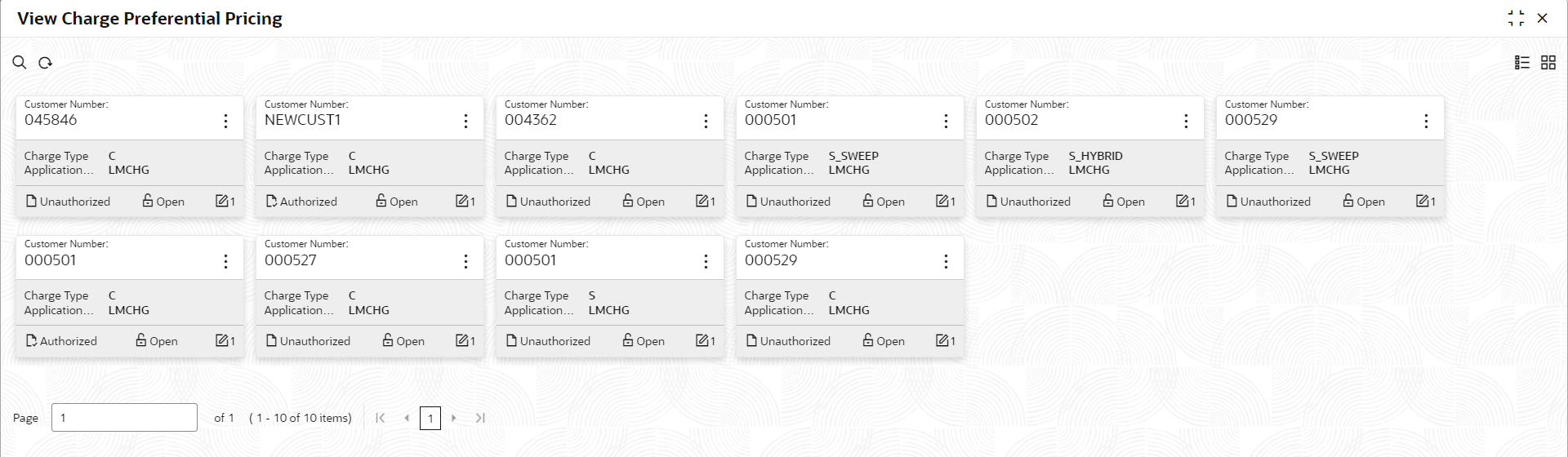

    The View Charge Preferential Pricing screen displays.
    Figure 17-17 View Charge Preferential Pricing

  4. Click Three dots and then select any of the following options:
    • Unlock – To modify the record details. Refer to the Create Charge Preferential Pricing screen for the field level details.
      • Click Audit to view the maker details, checker details of the record.
      • Click Show History hyperlink to view the historical data of the record.
    • Delete/Close – To remove the record.
      • Optional: In the confirmation pop-up window, click View to view the record details.
      • Click Proceed to delete the record.
    • Authorize – To authorize or reject the record. Authorizing/Rejecting requires necessary access rights.
      • Optional: Click View to view the record details.
      • If there are more than one modifications, Click Compare to view the comparison through the field values of old record and the current record.
      • Select the record and click Approve to approve the record.
      • Select the record and click Reject to reject the record. Specify the relevant comments in the pop-up window that appears, and click Confirm.

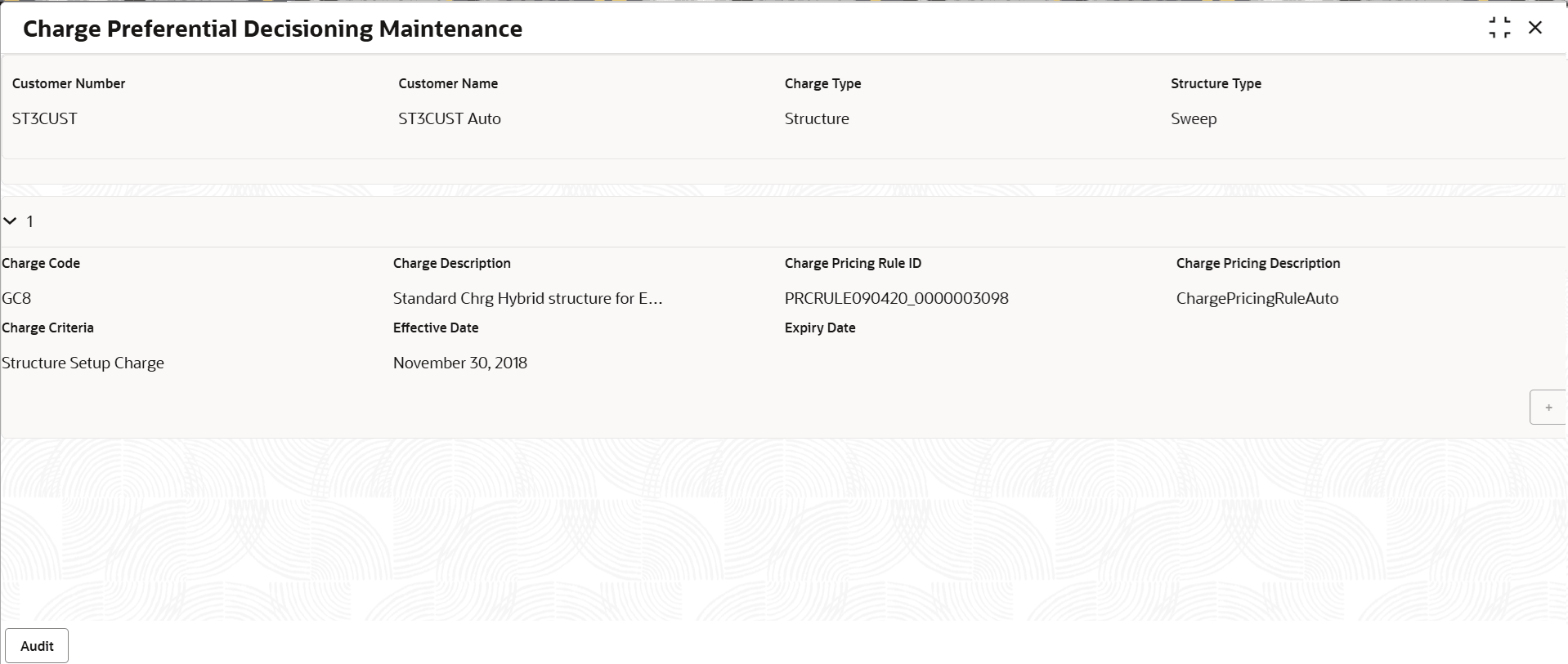

    • View – To view the record details.
      The Charge Preferential Decisioning Maintenance screen displays.
      Figure 17-18 Charge Preferential Decisioning Maintenance
      Table 17-23 Charge Preferential Decisioning Maintenance - Field Description
      Field Description
      Customer ID Displays the customer for which the preferential pricing has to be setup.
      Customer Name Displays the customer name based on selected customer ID.
      Charge Type Displays the type of the charge.
      The available options are:
      • Customer
      • Structure
      Structure Type Displays the type of the structure.
      • Sweep
      • Hybrid
      • Pool
      Charge Code Displays the charge code for preferential pricing configuration.
      Charge Code Description Displays the description of the selected charge code.
      Charge Pricing Rule ID Displays the charge pricing to be applied.
      Charge Pricing Description Displays the description of the selected Charge Pricing Rule.
      Charge Criteria Displays the criteria to be considered based on which the charges are calculated.
      The options are:
      • One Time Setup Charge
      • Structure Setup Charge
      • Count of Accounts
      • Count of Sweeps
      • Flat Maintenance Charge
      • Parent Charge Code
      Note: The taxes will be applicable based on the tax configured for the charge code in charge decisioning.
      Effective Date Displays the date from when the preferential pricing validity is effective.
      Expiry Date Displays the date from when the preferential pricing validity is effective.
