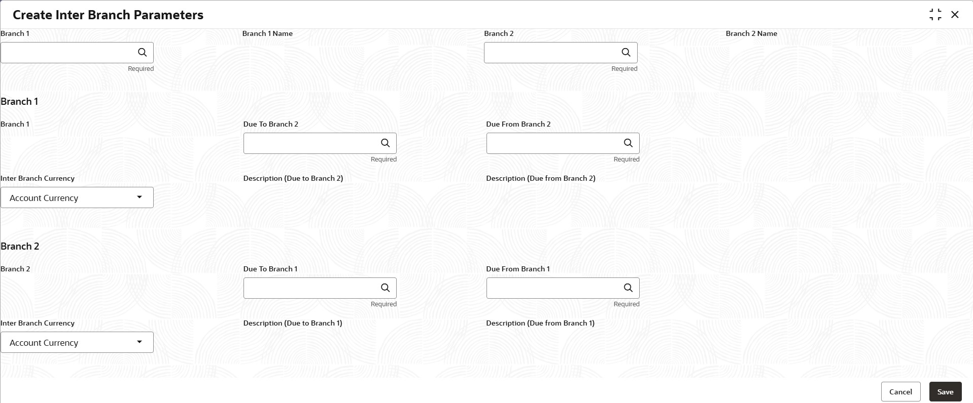

    The Create Inter Branch Parameters screen displays.
    Figure 3-4 Inter Branch Parameters
  2. Specify the following details, for more information on fields, refer to the field description table below.
    Table 3-5 Inter Branch Parameters
    Field Description
    Branch 1 Specify or select the appropriate code from the option list to identify the first branch for passing inter-branch entries.
    Branch Name Displays the branch name based on the branch code specified.
    Branch 2 Specify or select the appropriate code from the option list to identify the second branch for passing inter-branch entries.
    Due to Branch 2 This is the general ledger in Branch 1 where the system passes credit accounting entries.
    Due from Branch 2 This is the general ledger in Branch 1 where the system passes debit accounting entries.
    Inter Branch Currency for Branch 1 Select Inter branch currency for branch 1 from the drop-down list.
    The options are:
    • Account Currency
    • Transaction Currency
    If you select Account Currency, the system will record inter-branch entries using that currency. If you do not select it, the entries will be recorded in the transaction currency instead.
    Due to Branch 1 This is the general ledger in Branch 2 where the system passes credit accounting entries.
    Due from Branch 1 This is the general ledger in Branch 2 where the system passes debit accounting entries.
    Inter Branch Currency for Branch 2 Select Inter branch currency for branch 2 from the drop-down list.
    The options are:
    • Account Currency
    Descriptions Displays the descriptions according to the selection made for each general ledger in the appropriate fields.
