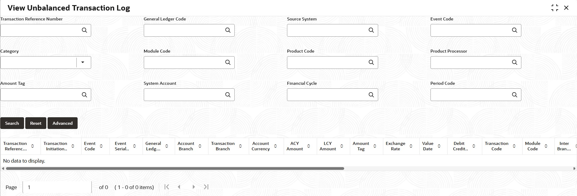

To view unbalanced transaction logs
  1. On the homepage, click Menu and click Operational Ledger and then click Enquiry. Under Enquiry, click View Unbalanced Transaction Log.
    The View Unbalanced Transaction Log screen displays.
    Figure 4-3 Unbalanced Transaction Log
  2. Specify the following details, for more information on fields, refer to the field description table below.
    Table 4-3 Unbalanced Transaction Log
    Field Description
    Transaction Reference Number Select the reference number of the transaction from the option list to view the unbalanced transactions.
    General Ledger Code Select the general ledger code from the option list to view the unbalanced transactions.
    Source System Select the source system from the option list to view the unbalanced transactions.
    Event Code Select the event code from the option list to view the unbalanced transactions.
    Category Select the type of category from the drop-down list.
    The options are:
    • Asset
    • Liability
    • Income
    • Expense
    • Contingent Asset
    • Contingent Liability
    Product Processor Select the product processor of the transaction from the option list to view the unbalanced transactions.
    System Account Select the system account from the option list to view the unbalanced transactions.
    Financial Cycle Select the financial cycle of the transaction from the option list to view the unbalanced transactions.
    Period Code Select the period code from the option list to view the unbalanced transactions.
    Module Code Select the module code from the option list to view the unbalanced transactions.
    Note: This field appears when you click the Advanced button.
    Product Code Select the product code from the option list to view the unbalanced transactions.
    Amount Tag Select the amount tag from the option list to view the unbalanced transactions.
  3. After specifying the above details, perform one of the following actions:
    • Click the Search button to view the unbalanced transaction details.
    • Click the Reset button to clear the search criteria.
