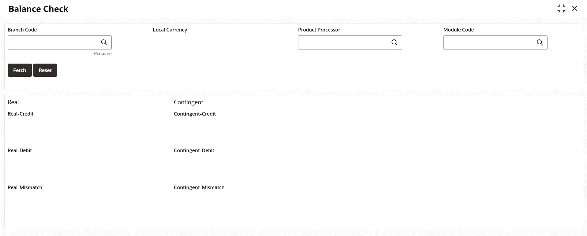

To view the GL balance
  1. On the homepage, click Menu and click Operational Ledger and then click Enquiry. Under Enquiry, click Balance Check.
    The Balance Check screen displays.
  2. On the Balance Check screen, specify the following details, for more information on the fields, refer to the field description table below.
    Table 4-10 Balance Check
    Field Description
    Branch Code Select the branch code from the option list to view the GL balance.
    Local Currency Auto populates the local currency based on the branch code selected.
    Product Processor Select the product processor from the option list that you want to view the GL balance.
    Module Code Choose the module code from the option list that the user wants to use to view the GL balance.
  3. After specifying the above details, perform one of the following actions:
    • Click the Fetch button to view the real and contingent balance.
    • Click the Reset button to clear the search criteria.
