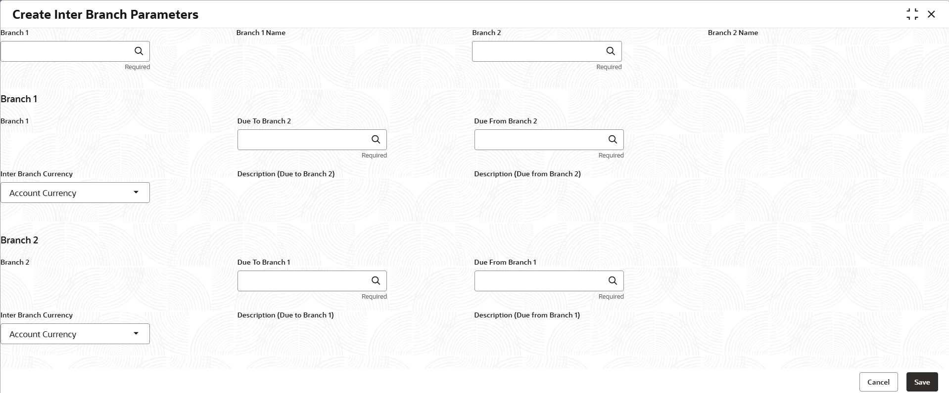

  1. On the homepage, click Menu and click Operational Ledger, and then click Maintenance. Under Maintenance, click Inter Branch Parameters Maintenance, and click Create Inter Branch Parameters.
    The Create Inter Branch Parameters screen displays.
    Figure 3-4 Inter Branch Parameters
  2. Specify the following details, for more information on fields, refer to the field description table below.
    Table 3-5 Inter Branch Parameters

    Branch 1 Specify or select the appropriate code from the option list to identify the first branch for passing inter-branch entries.
    Branch Name Displays the branch name based on the branch code specified.
    Branch 2 Specify or select the appropriate code from the option list to identify the second branch for passing inter-branch entries.
    Due to Branch 2 This is the general ledger in Branch 1 where the system passes credit accounting entries.
    Due from Branch 2 This is the general ledger in Branch 1 where the system passes debit accounting entries.
    Inter Branch Currency for Branch 1 Select the inter-branch currency for branch 1 from the drop-down list.
    The options are:
    • Account Currency
    • Transaction Currency
    If user select Account Currency, the system will record inter-branch entries using that currency. If user do not select it, the entries will be recorded in the transaction currency instead.
    Due to Branch 1 This is the general ledger in Branch 2 where the system passes credit accounting entries.
    Due from Branch 1 This is the general ledger in Branch 2 where the system passes debit accounting entries.
    Inter Branch Currency for Branch 2 Select the inter-branch currency for branch 2 from the drop-down list.
    The options are:
    • Account Currency
    Descriptions Displays the descriptions according to the selection made for each general ledger in the appropriate fields.
