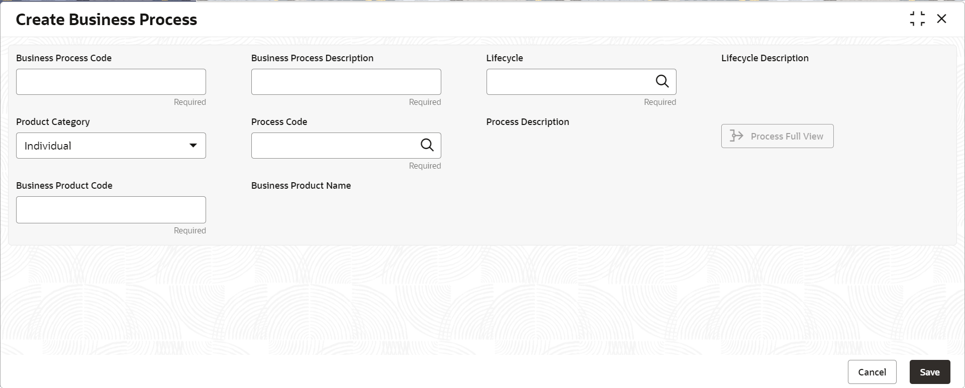

- From Home screen, click Retail Banking. Under Retail Banking, click Configuration.
- Under Configuration, click Business Process.
- Under Business Process, click Create Business
Process.
The Create Business Process screen displays.
- Specify the fields on Create Business Process
screen.
The fields, which mentioned as Required, are mandatory.This topic contains the following subtopics:
Table 1-14 Create Business Process – Field Description
Field Description Business Process Code Specify an alphanumeric business process code.
Maximum Length allowed is 16.
Business Process Description Specify the description of the business process code.
Maximum Length allowed is 60.
Lifecycle Search and select the lifecycle code. Lifecycle Description Displays the description of the lifecycle selected. Product Category Select the product category.
Available options are
- Individual
- Small and Medium Business
Process Code Search and select the process code of the business process flow that needs to be mapped for the lifecycle code and business process code combination. Process Description Displays the description of the selected process code. Business Product Code Specify the business product code for which the business process is being created. Alternatively, system allows to select ‘All’, in which case the business process will be applicable to all the business products that are associated with the Lifecycle and Process Code. Business Product Name Displays the business product name based on the product code selected. Note:
System will allow you to configure only one business process for a combination of Lifecycle and Business Product Code. - Search and select the Process Code.
The Create Business Process screen with stages displays.
Figure 1-15 Create Business Process screen with stages
- Click Save to save the data captured.
- Click Cancel to close the business process screen.The Create Business Process configuration allows to configure the below elements for each of the stages of the Product Origination workflow:
