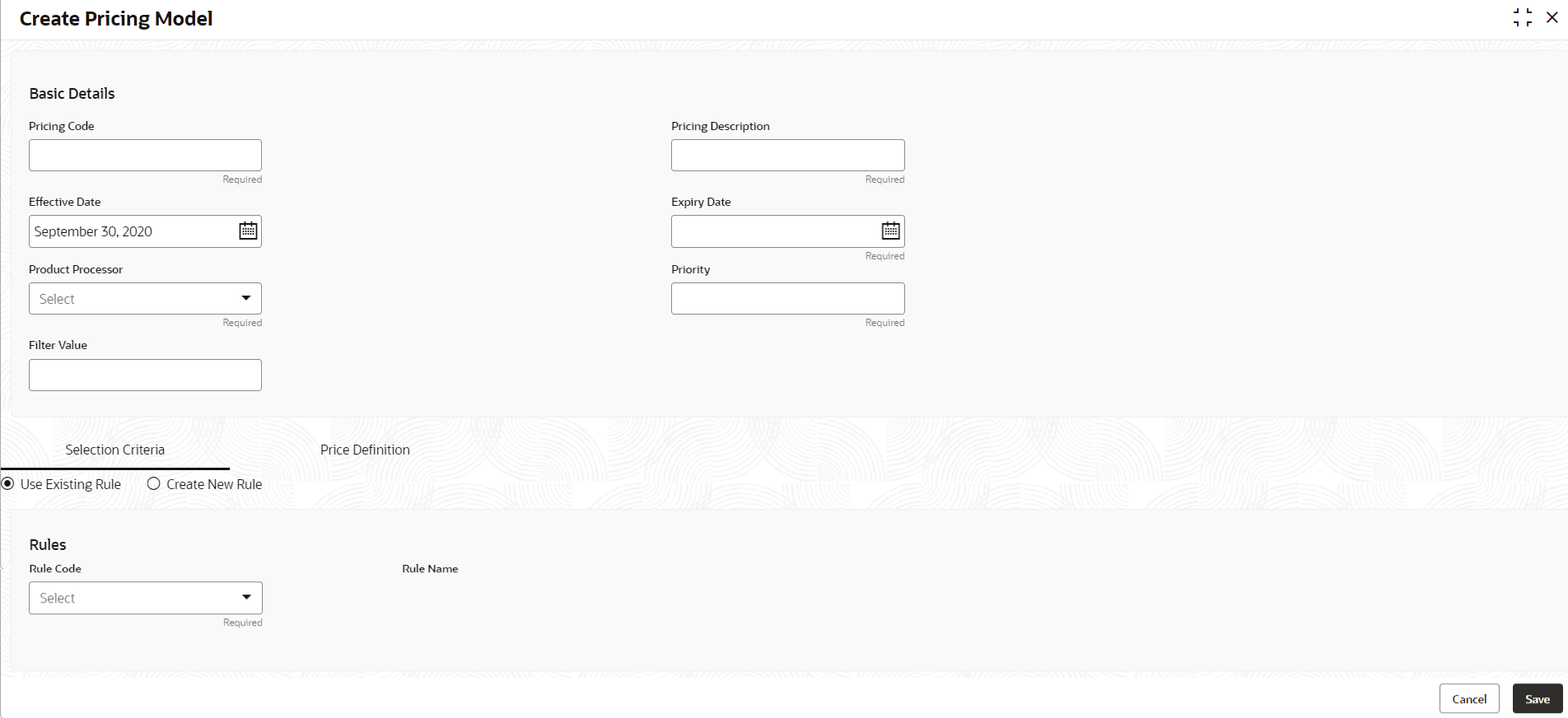

    The Create Pricing Model screen displays.
    Figure 1-86 Create Pricing Model
  5. On Create Pricing Model screen, specify the fields.
    The fields marked as Required are mandatory.

  6. Click the Selection Criteria to define pricing model.
    Figure 1-87 Create Pricing Model – Selection Criteria

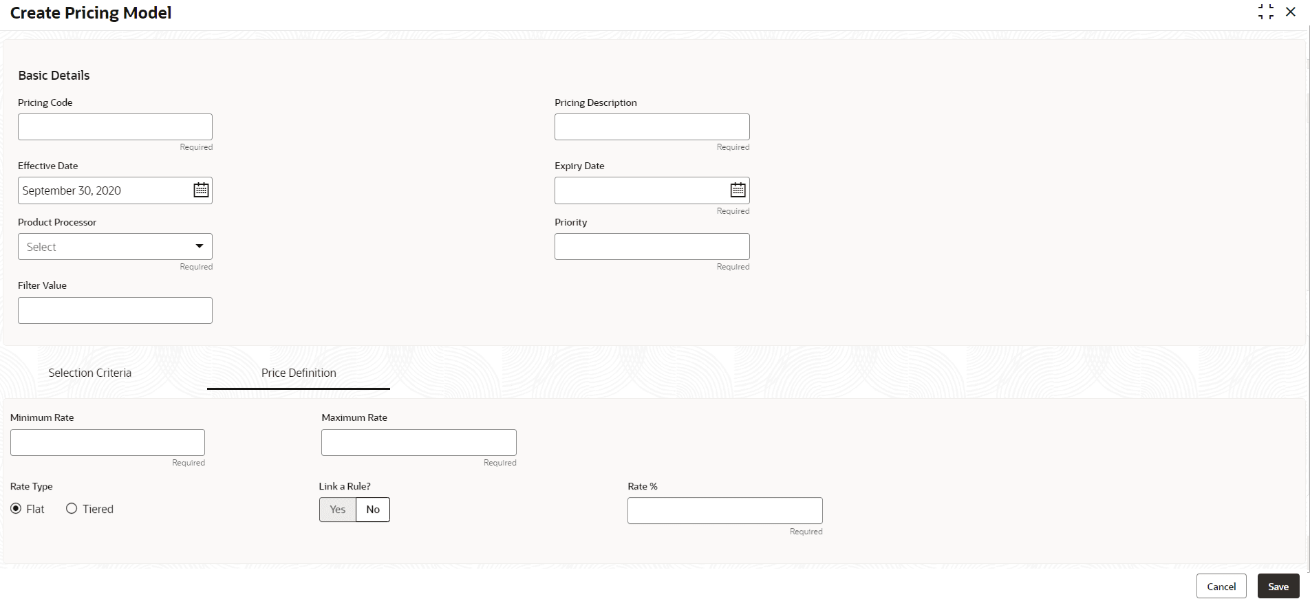

  7. Click Price Definition to define the pricing.
  8. Select the Rate Type options as Flat to specify the flat rate.
    The Create Pricing Model – Price Definition (Flat) screen displays.
    Figure 1-88 Create Pricing Model – Price Definition (Flat)
    Table 1-89 Create Pricing Model – Price Definition (Flat) - Field Description
    Field Description
    Minimum Rate Specify the minimum rate applicable for the defined pricing code.
    Maximum Rate Specify the maximum rate applicable for the defined pricing code.
    Rate Type Select the rate type from the drop-down list as Flat.

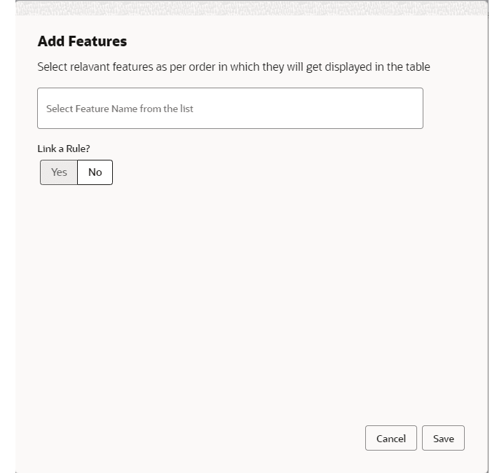

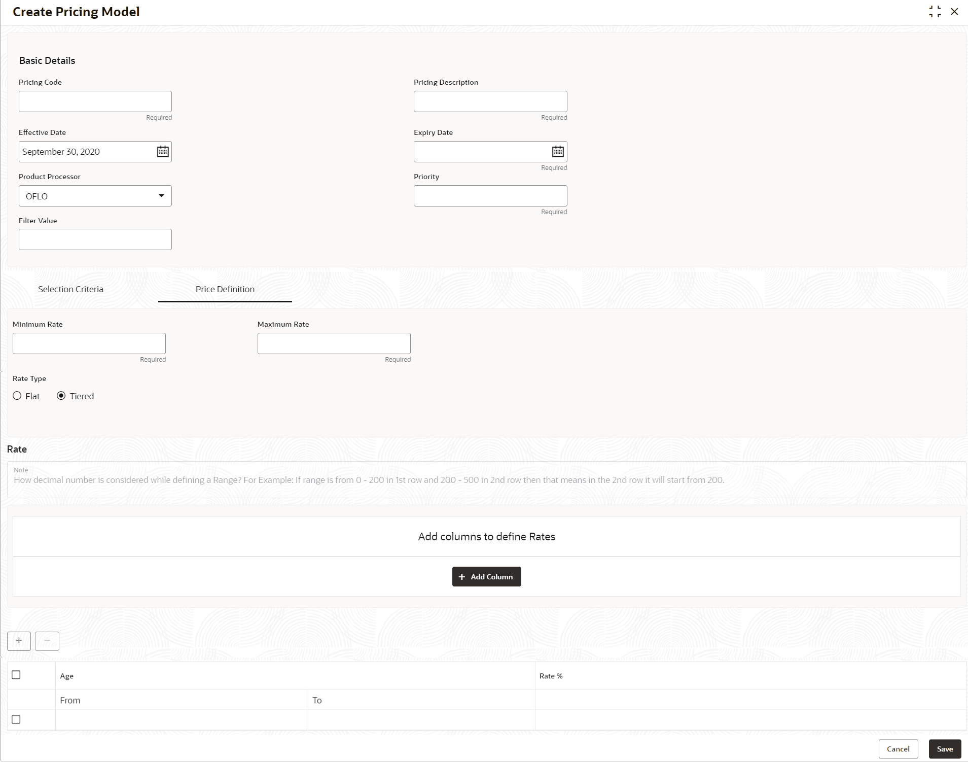

  9. Select the Rate Type options as Tiered to link the list of features.
  10. Click Add Columns to select and link the features.
    The Add Features popup screen displays.
  11. Select the feature names from the list. (ā€˜n’ number of features can be selected)
  12. Select the option whether to link a rule for defining the interest rate.
  13. Click Save to link the list of features for defining the tiered interest rate.
    The Create Pricing Model – Price Definition (Tiered) screen displays.
    Figure 1-90 Create Pricing Model – Price Definition (Tiered)
