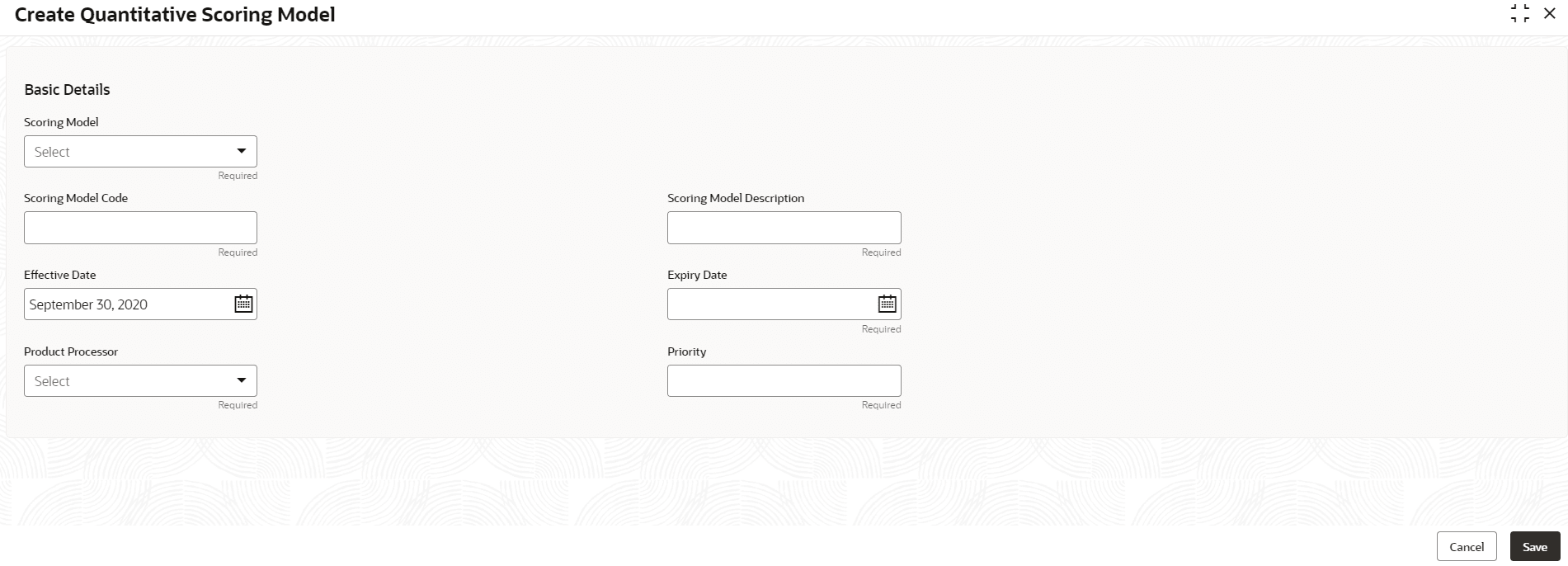

The Create Quantitative Scoring Model screen allows the user to create the quantitative scoring model by linking the various features. The user needs to create quantitative scoring models for both the application and applicant level.
- On Home screen, click Retail Banking. Under Retail Banking, click Configuration.
- Under Configuration, click Credit Decision.
- Under Credit Decision, click Quantitative Scoring Model.
- Under Quantitative Scoring Model, click Create Quantitative Scoring Model.The Create Quantitative Scoring Model screen displays.
Figure 1-59 Create Quantitative Scoring Model
- Specify the fields on Create Quantitative Scoring Model
screen.For more information on fields, refer to the field description table.
The fields marked as Required are mandatory.Table 1-52 Create Quantitative Scoring Model - Field Description
Field Description Scoring Model Select the scoring model from the drop-sown list. The available options are:- Application Scoring Model
- Applicant Scoring Model
- Multi-Applicant Scoring Model

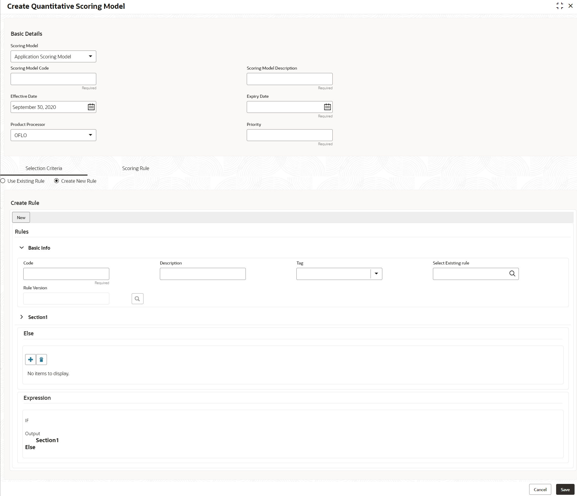

Scoring Model Code Specify the unique scoring model code. Scoring Model Description Specify a short description for the scoring model. Effective Date Specify the effective date. Expiry Date Specify the expiry date. Product Processor Specify the product processor for which the model is being created. Priority Specify the priority of the model. - Click the Selection Criteria to define quantitative scoring model.For more information on fields, refer to the field description table.
Figure 1-60 Create Quantitative Scoring Model - Selection Criteria
Table 1-53 Create Quantitative Scoring Model - Selection Criteria - Field Description
Field Description Use Existing Rule By default, this option is enabled. Indicates if the existing rule is linked. Rule Code Select the rule code from the drop down list.
Click this icon to get the information about the existing rule. Rule Name Displays the rule name of the selected rule code. Create New Rule Select this option to create new rule. Code Specify the rule code. Description Specify the rule description. + icon Click this icon to add new expression. Fact / Rules Select the fact or rule from the drop-down list. Once the user selects the fact/rules, one more field opens adjacent to the output, update the same based on the selected output option.

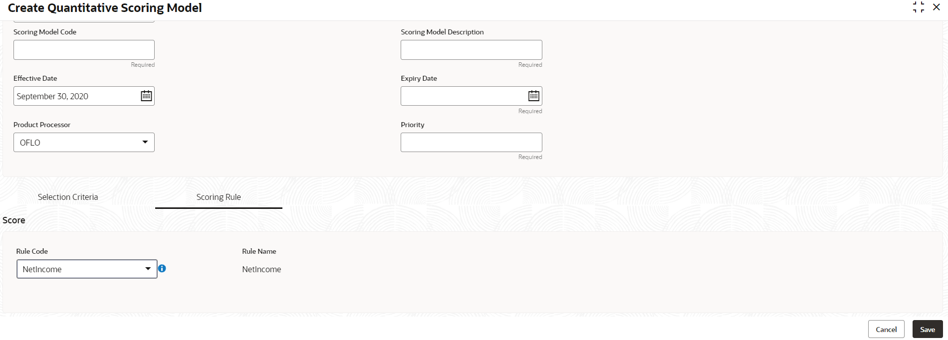

Expression Displays the expression updated in the expression builder. - Click the Scoring Rule to define the rules. This tab is enabled if Application Scoring Model is selected.The Create Quantitative Scoring Model - Scoring Rule screen displays.For more information on fields, refer to the field description table.
Figure 1-61 Create Quantitative Scoring Model - Scoring Rule
Table 1-54 Create Quantitative Scoring Model - Scoring Rule - Field Description
Field Description Rule Code Select the rule code from the drop-down list.

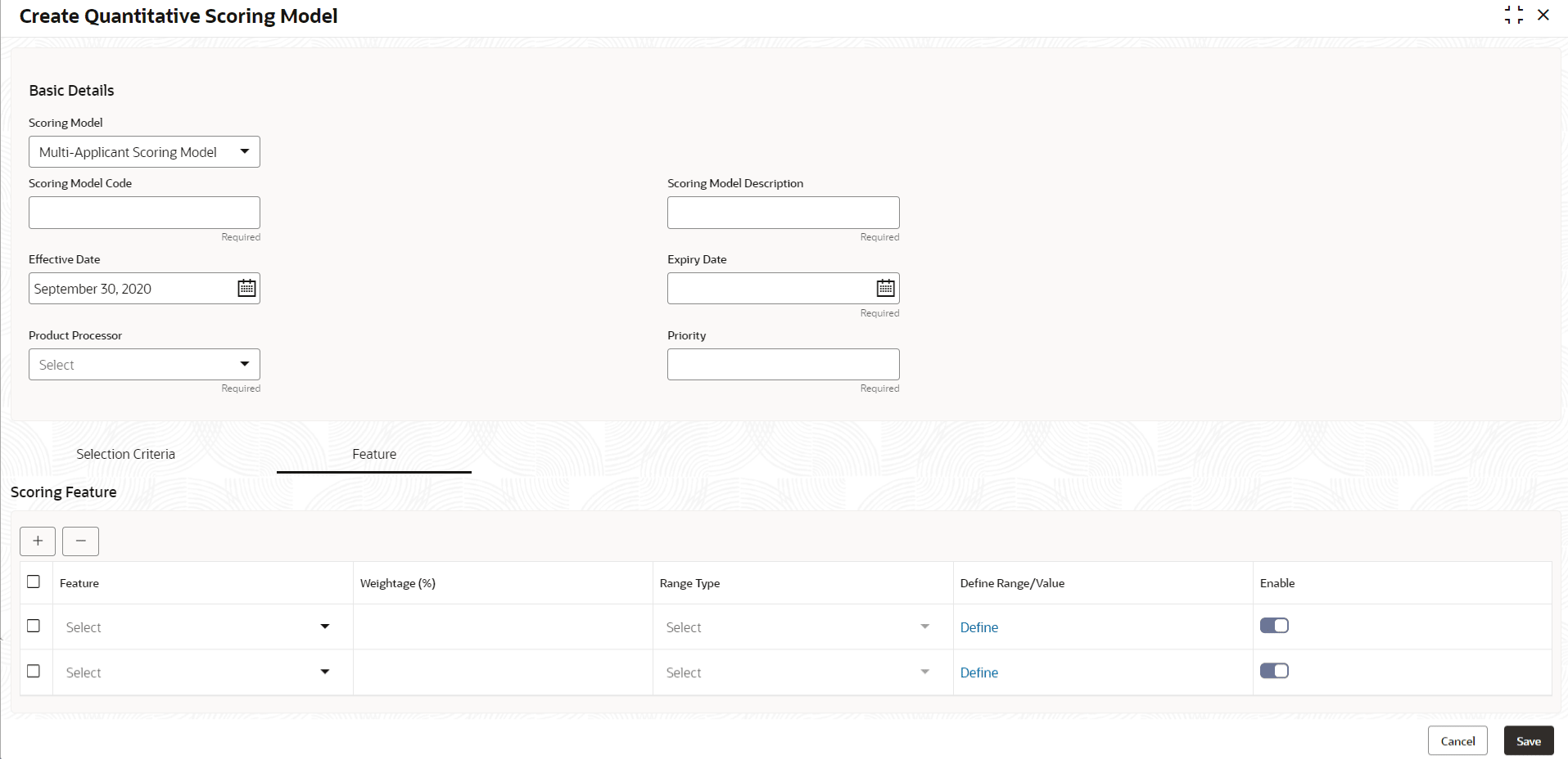

Click this icon to get the information about the rule. Rule Name Displays the rule name of the rule code. - Click the Feature tab to define the feature. This tab is enabled if Applicant Scoring Model and Multiple Applicant Scoring Model is selected.The Create Quantitative Scoring Model - Feature screen displays.For more information on fields, refer to the field description table.
Figure 1-62 Create Quantitative Scoring Model - Feature
Table 1-55 Create Quantitative Scoring Model - Feature - Field Description
Field Description + icon Click this icon to add a new row. - icon Click this icon to delete a row, which is already added. Feature Select the feature from the drop-down list. Weightage (%) Specify the weightage to be assigned to each feature code. Range Type Select the range type from the drop down list.

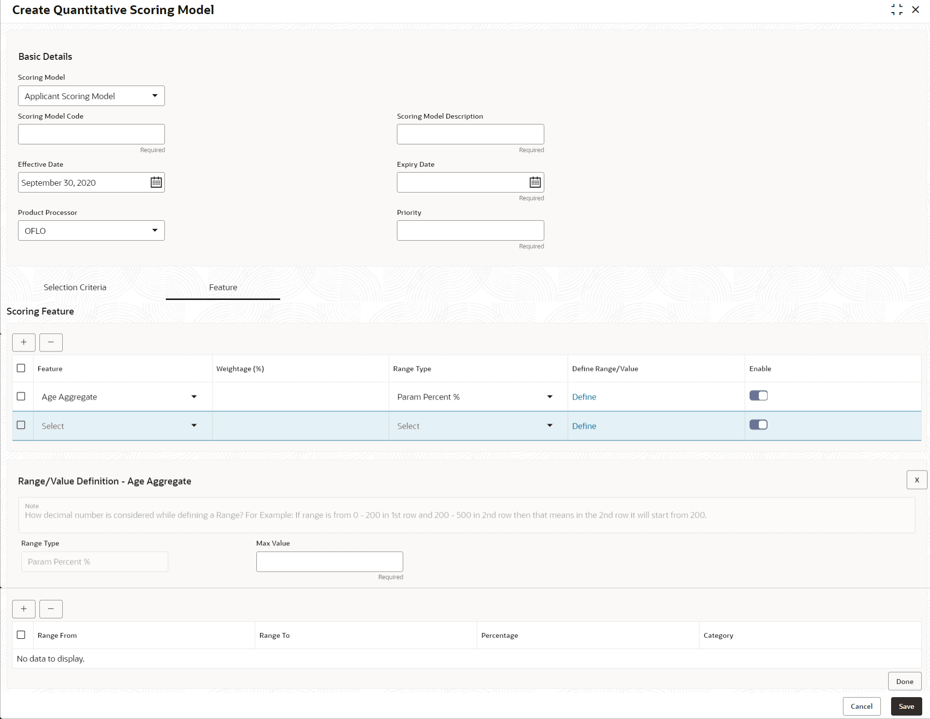

Define Range/Value Click the Define link to define the score for the expected response. Enable By default, this option is enabled. Indicates if the scoring parameter is enabled or not. - Click the define link to define a range or absolute values for each scoring feature to be considered for scoring model and score for that range or value.In case the data type of feature is numeric such as Bureau score, the Create Quantitative Scoring Model - Define Link - Numeric Feature screen displays.For more information on fields, refer to the field description table.
Figure 1-63 Create Quantitative Scoring Model - Define Link - Numeric Feature
Table 1-56 Create Quantitative Scoring Model - Define Link – Numeric Feature - Field Description
Field Description Range Type Displays the range type selected. Max Value Specify the maximum value on which scoring has to be done, if range type ID is Max Value % or Param %. + icon Click this icon to add a new row. - icon Click this icon to delete a row, which is already added. Range From Specify the minimum range of value based on which scoring is to be done. Range To Specify the maximum range of value based on which scoring is to be done. Score/Percentage Specify the percentage to be assigned for each range or value, if range type is Max value % or Param %.
Specify the score to be assigned for each range or value, if range type is Value.Category Specify the category for each range or value from the drop-down list. The values are configurable based on the lookup values maintained. The available options are:- Strong
