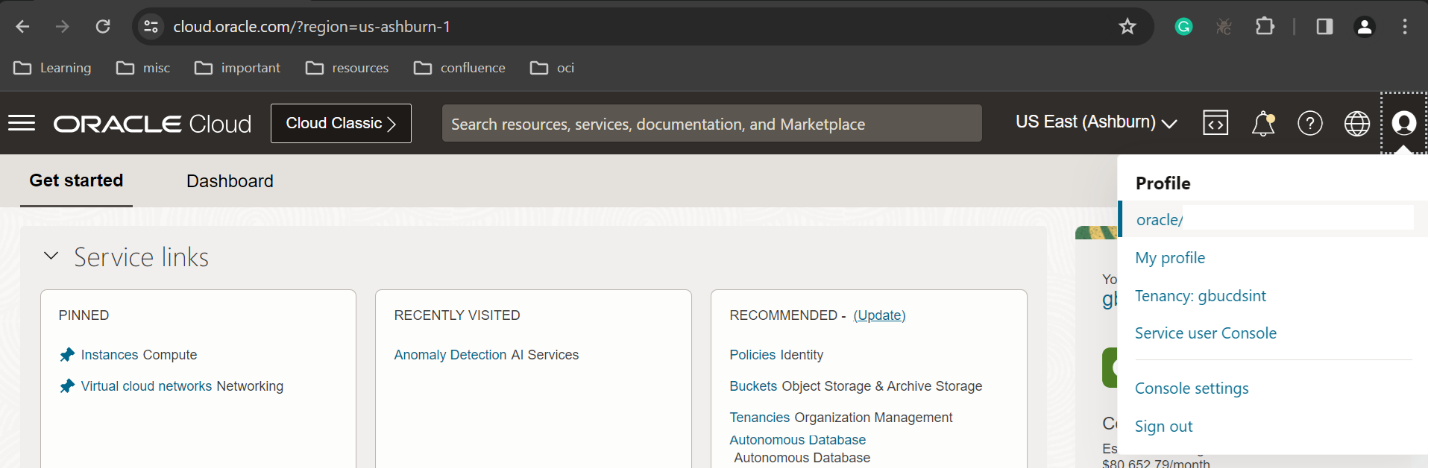

  2. Access the OCI Link and login to OCI using your credentials.
  3. Click Profile option from the menu bar. The option to login in profile appears.
  4. Click oracle/<Your email ID> option.
    Figure 11-1 Login with your credentials

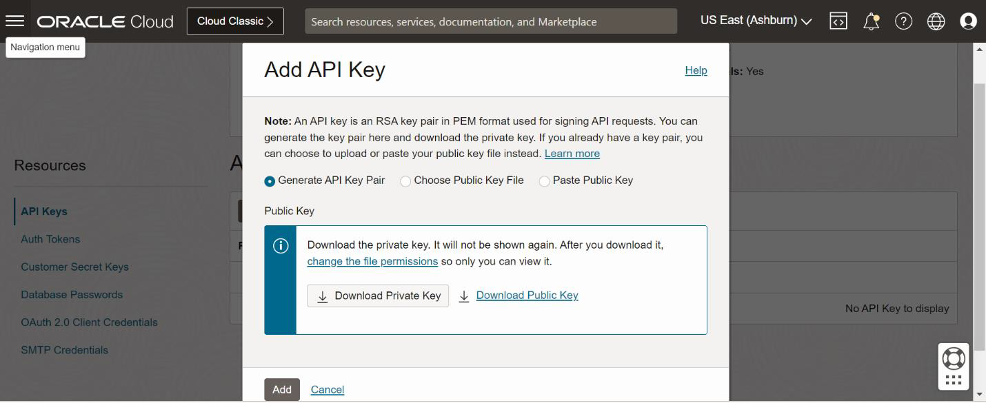

  5. Scroll down to the page and click on Add API Key. The Add API Key page appreas.
  6. Click the Download Private Key button. The key get downloaded.

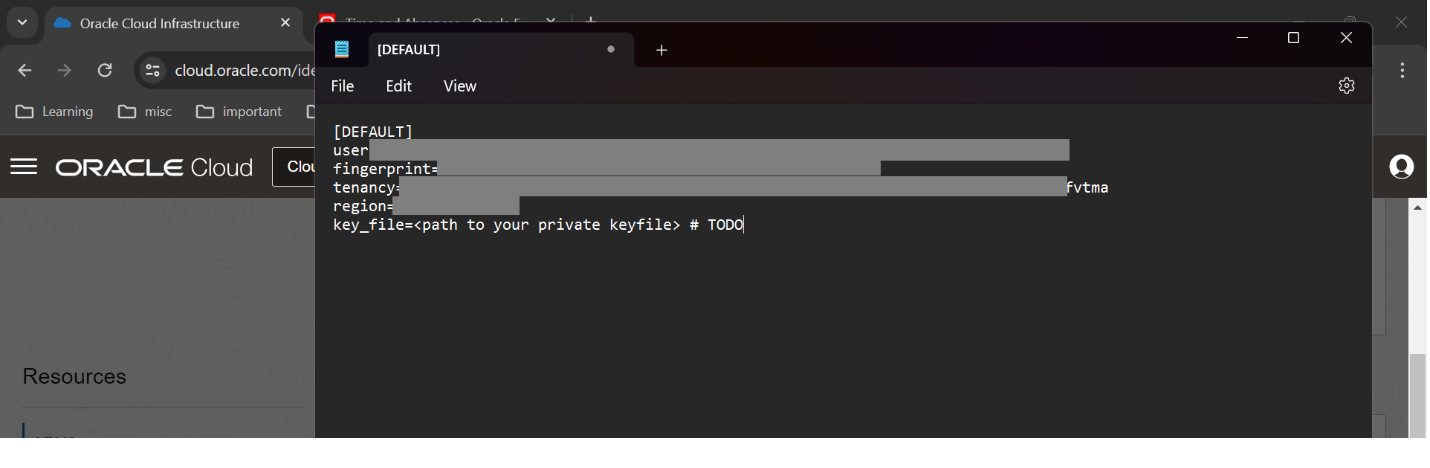

  7. Copy the key and enter it in the Select API Key Fingerprint field. The Configuration File Preview window appears.
    Figure 11-3 Configuration File Preview
  8. Save the file in the secret named folder which is already created in Step 1.
  9. Copy the downloaded private keys in the secret folder.
  10. Edit oci_config.txt file. Change the key file path to the path of the private file in the secret folder. For example: key_file=./secret/oracle_oci.user-01-29-09-12.pem
  11. Save the file oci_config.txt.
