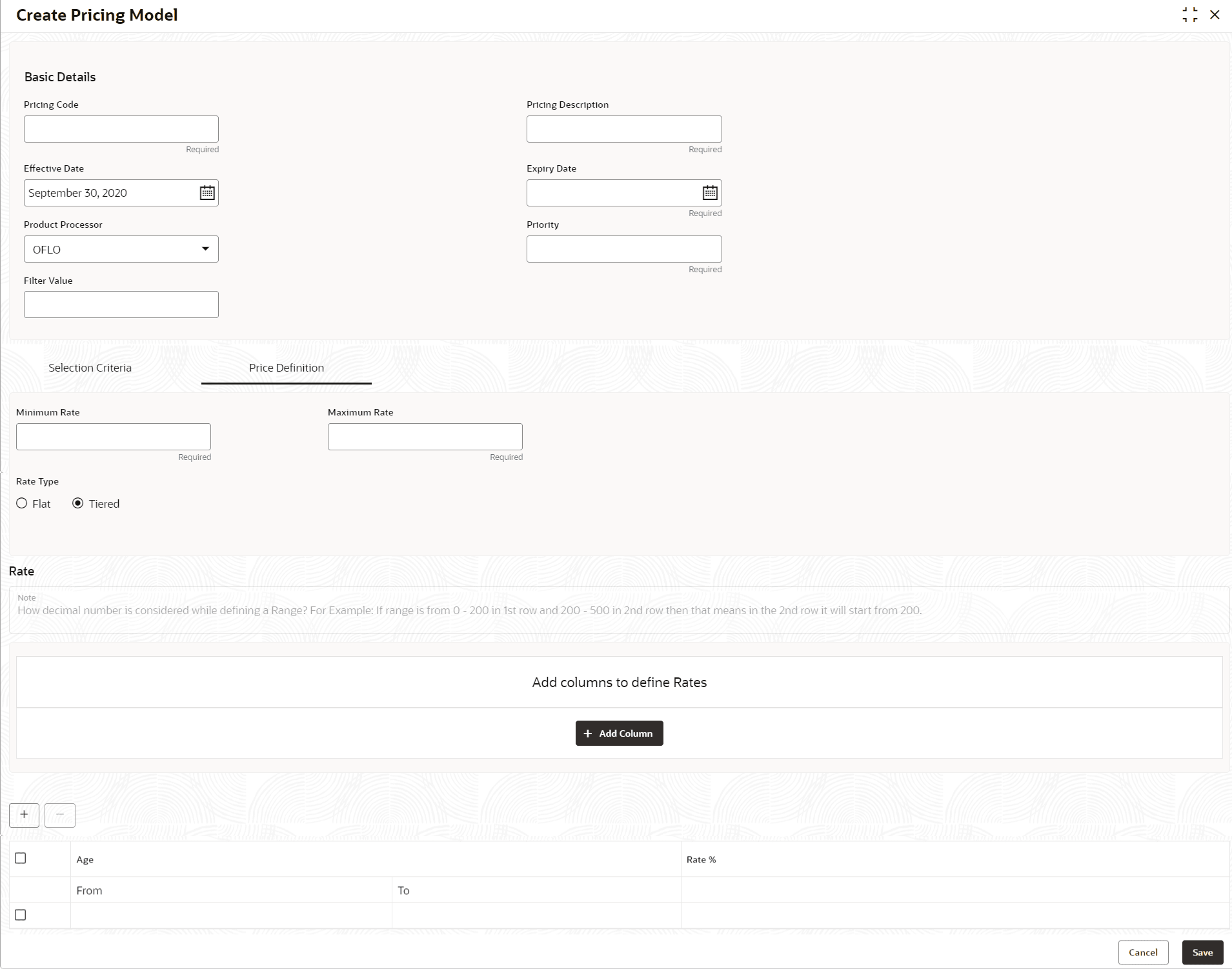

Expression Displays the expression updated in the expression builder. - Click Price Definition to define the pricing.
- Select the Rate Type options as Flat to specify the flat rate.The Create Pricing Model – Price Definition (Flat) screen displays.For more information on fields, refer to the field description table.
Figure 1-88 Create Pricing Model – Price Definition (Flat)
Table 1-89 Create Pricing Model – Price Definition (Flat) - Field Description
Field Description Minimum Rate Specify the minimum rate applicable for the defined pricing code. Maximum Rate Specify the maximum rate applicable for the defined pricing code. Rate Type Select the rate type from the drop-down list as Flat. Link a Rule? Select the option whether to link a rule to derive the price. The options are:- Yes
- No
Rate % Specify the interest rate application for the defined pricing. This field displays once you select the Rate Type option as Flatand Link a Rule? option as No.
Rule Select the rule for the defined pricing from the drop-down list. This field appears once you select the Rate Type option as Flat and Link a Rule? option as Yes.

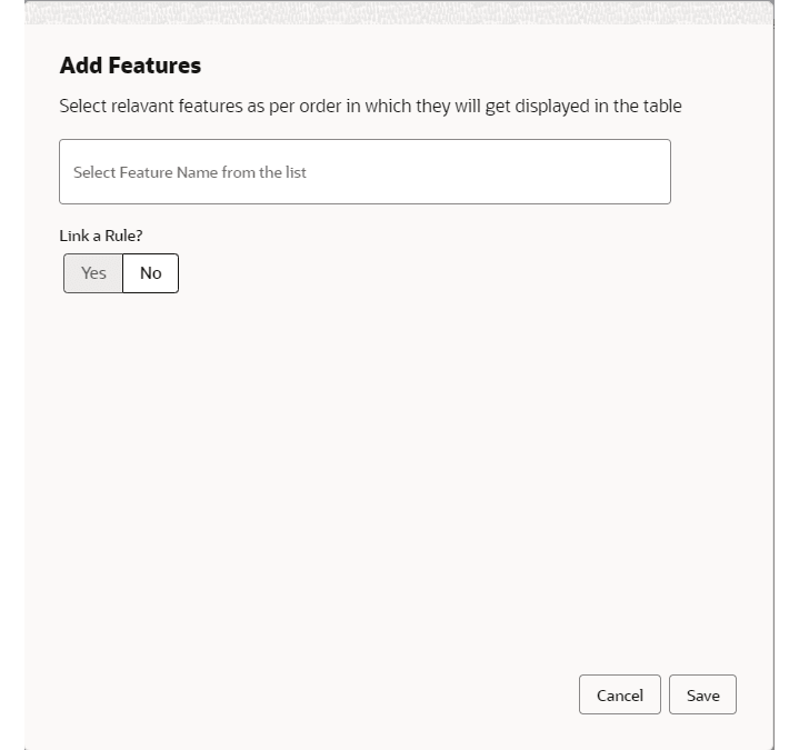

- Select the Rate Type options as Tiered to link the list of features.
- Click Add Columns to select and link the features.The Add Features popup screen displays.
- Select the feature names from the list. (ānā number of features can be selected)
- Select the option whether to link a rule for defining the interest rate.
- Click Save to link the list of features for defining the tiered interest rate.The Create Pricing Model – Price Definition (Tiered) screen displays.For more information on fields, refer to the field description table.
Figure 1-90 Create Pricing Model – Price Definition (Tiered)
Table 1-90 Create Pricing Model – Price Definition (Tiered) - Field Description
Field Description Minimum Rate Specify the minimum rate applicable for the defined pricing code. Maximum Rate Specify the maximum rate applicable for the defined pricing code. Rate Type Select the rate type from the drop-down list as Tiered. <Numeric Feature> From Specify the minimum numeric value of feature to which the interest rate is applicable. <Numeric Feature> To Specify the maximum numeric value of feature to which the interest rate is applicable. <Character Feature> Value Specify the alphabetic value for which the interest rate is applicable. Rate % Specify the interest rate applicable for the defined tier. This field appears once you select the Rate Type option as Tiered and Link a Rule? option as No.
Rule Select the rule for the defined tier from the drop-down list. This field appears once you select the Rate Type option as Tiered and Link a Rule? option as Yes.
