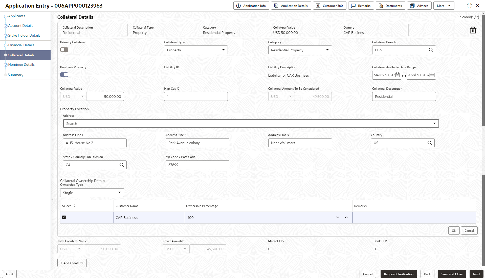

The Collateral Details screen displays.

- Specify the details in the relevant data fields. For more information on fields, refer
to the field description table below.
Table 2-11 Collateral Details - Field Description
Field Description Primary Collateral Specify the primary collateral. Collateral Type Select the collateral type. Available options are:

Collateral Branch Displays the branch of the collateral. Term Deposit Number Select the Term Deposit Number from the list.
The Term Deposit which has crossed the maturity date and the “Allow Collateral Linkage” disabled, will not appear in the list.
Maturity Date Select the Maturity Date of the term deposit. Available Linkage Amount Specify the available linkage amount. Linked Amount Specify the linked amount. Linkage Currency Displays the linkage currency. Guarantee Type Specify the type of guarantee.
This field appears only if the collateral type is Guarantee.
Currency Specify the currency of the collateral value. Collateral Value Specify the collateral value. Collateral Description Specify the collateral description. Mark Collateral For Refinance Specify if an added collateral should be consider for refinance. Applicants This section displays the applicants name and remarks that are involved in the loan application. These applicants are also related to the added collateral. Guarantor This section displays the guarantor name. Purchase Property Specify whether the collateral property being added is being purchased.
This field appears if the Property option is selected from the Collateral Type list.
Liability ID Displays the Liability ID Liability Description Displays the Liability description. Collateral Available Date Range Select the date range of the collateral. The range indicates the date from and date up to, which the collateral is available. Collateral Value Specify the value of the collateral. Hair Cut % Specify the percentage of Hair Cut. Collateral Amount To Be Considered Displays the collateral amount to be considered.
Collateral Amount = (Hair Cut % Collateral Value)
Collateral Description Specify the collateral description. Property Location In this section you can enter property address which is added as collateral. This section appears only if you select Property from the Collateral Type list.
The fields appears if you select the Property option from the Collateral Type list.
Address Specify the address to search already captured address.
Based on configuration, on entering few letters, the system fetches the related address that are already captured.
Based on the selection, the fields are auto populated in the address section.
Address Line 1 Specify the building name. Address Line 2 Specify the street name. Address Line 3 Specify the city or town name. State / Country Sub Division Specify the state or country sub division. Country Select and search the country code. Zip Code / Post Code Specify the zip or post code of the address. Collateral Ownership Details In this section you specify the ownership details of the collateral property. This section displays all the customers that are involved in the loan application.

<Added record tile> In this tile you can view the added details. Click Add to add the applicant collateral ownership details.
Click Edit to edit the added collateral ownership details.
Click
to delete the collateral ownership details.
Ownership Type Select the ownership type of the property.
The available options are
- Single
- Joint
Select Select the appropriate customer as owner from the list.
Customer Name Displays the customer name along with title.
Ownership Percentage Displays the percentage of the ownership of the customer.
Remark Displays the remark of the customer.
Action Click
to edit the added signaturesClick
to delete the added signatures.Market LTV Displays the market LTV. Bank LTV Displays the bank LTV. Collateral Description Displays the description of the collateral. Collateral Type Displays the collateral type. Category Displays the category of the collateral. Collateral Value Displays the collateral value. Owners Displays the owner names of the collateral. <Actions> Displays the actions that you can perform on the added collateral.
- Click delete to delete the added collateral.
- Click down arrow to view the collateral details.
Total Collateral Value Displays the total value of collateral.
This field will be auto updated based on the number of collaterals.
Cover Available Displays the cover available.
All the fields are fetched from Oracle Banking Credit Facilities Process Management in read only mode, if integrated with Oracle Banking Credit Facilities Process Management. - Click Next to navigate to the next data segment, after successfully capturing the data. The system validates for all mandatory data segments and data fields. If mandatory details are not provided, the system displays an error message for the user to take an action. The User cannot to proceed to the next data segment, without capturing the mandatory data.
