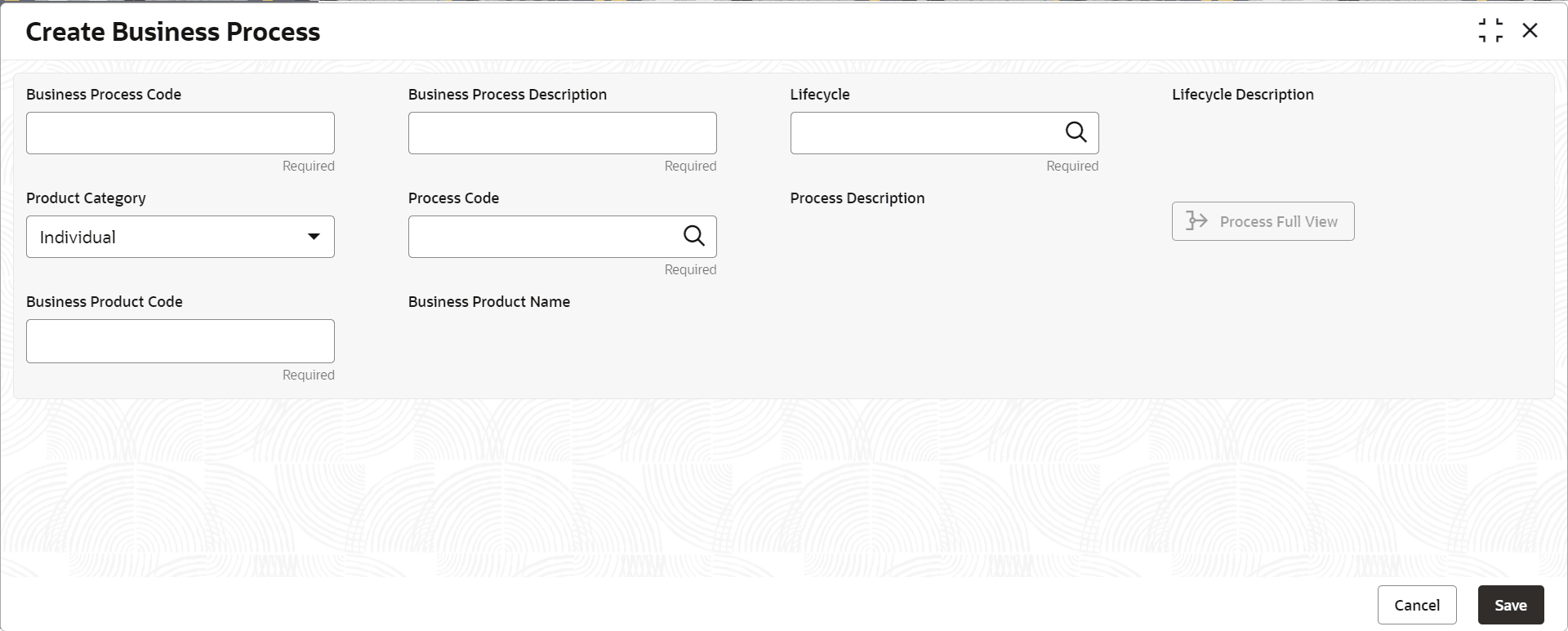

    The Create Business Process screen displays.
    Figure 1-16 Create Business Process
  4. Specify the fields on Create Business Process screen.
    The fields, which mentioned as Required, are mandatory.

    Table 1-16 Create Business Process – Field Description
    Field Description
    Business Process Code
    Specify an alphanumeric business process code.
    Maximum Length allowed is 16.
    Business Process Description
    Specify the description of the business process code.
    Maximum Length allowed is 60.
    Lifecycle Search and select the lifecycle code.
    Lifecycle Description Displays the description of the lifecycle selected.
    Product Category
    Select the product category.
    Available options are
    • Individual
    • Small and Medium Business
    Process Code Search and select the process code of the business process flow that needs to be mapped for the lifecycle code and business process code combination.
    Process Description Displays the description of the selected process code.
    Business Product Code Specify the business product code for which the business process is being created. Alternatively, system allows to select ‘All’, in which case the business process will be applicable to all the business products that are associated with the Lifecycle and Process Code.
    Business Product Name Displays the business product name based on the product code selected.
    Factory Shipped Select the factory shipped
    The available options are:
    • Yes
    • No
    System will allow you to configure only one business process for a combination of Lifecycle and Business Product Code.

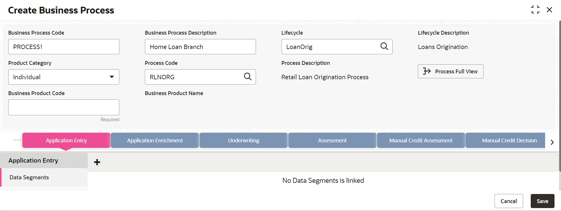

  5. Search and select the Process Code.
    The Create Business Process screen with stages displays.
    Figure 1-17 Create Business Process screen with stages
  6. Click Save to save the data captured.
  7. Click Cancel to close the business process screen.
