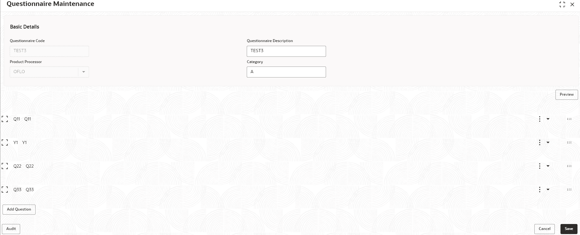

  5. On View Questionnaire screen, click Three dots to Unlock, Delete, Authorize or View the created questionnaire.
  6. Click Unlock to modify the created questionnaire.
    The Questionnaire Maintenance - Modify screen displays.
    Figure 1-40 Questionnaire Maintenance - Modify
    The fields marked as Required are mandatory.
    Table 1-36 Questionnaire Maintenance - Modify - Field Description
    Field Description
    Questionnaire Code Displays the questionnaire code.
    Questionnaire Description The user can modify the questionnaire description.
    Product Processor Displays the product processor for the created questionnaire.
    Category The user can modify the category for the created questionnaire.
    Preview Click Preview to display the questions configured for the questionnaire along with the response choice.
    Down Click this icon to expand, copy, or remove question.
    Handburger Click this icon to move the position of the questions.
    Maximize Click this icon to see the question details.
    Question Code Displays the question code for the created questionnaire.
    Question Description The user can modify the question code for the created questionnaire.
    Select-Type Displays the type of questionnaire.
    Select Sub-Type Displays the sub-type of questionnaire.
    Short Name User can modify the short name of the created questionnaire.
    Comments User can modify the comments of the created questionnaire.
    Required Switch the toggle to modify if the question is mandatory or optional.
    Add Condition Click Add Condition to display the existing rule. However, user can create a new rule by clicking Create New Rule option.
    Answer Code Displays the answer code.
    Answer Option User can modify all the expected response for the question configured.
  7. Click Save to update the modified fields.

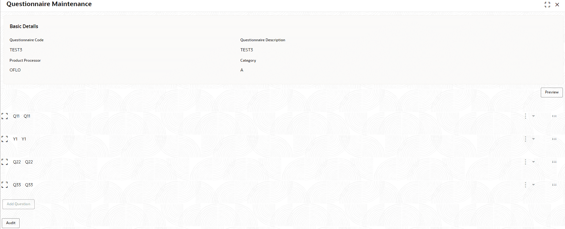

  8. Click View to view the created logical model.
    The Questionnaire Maintenance – View screen displays.
    Figure 1-41 Questionnaire Maintenance – View
    Table 1-37 Questionnaire Maintenance - View - Field Description
    Field Description
    Questionnaire Description Displays the questionnaire description.
    Category Displays the category of the created questionnaire.
    Question Description Displays the question code for the created questionnaire.
    Select Type Displays the type of questionnaire.
    Short Name Displays the short name of the created questionnaire.
    Required Displays if the question is mandatory or optional.
    Answer Option Displays all the expected response for the question configured.
