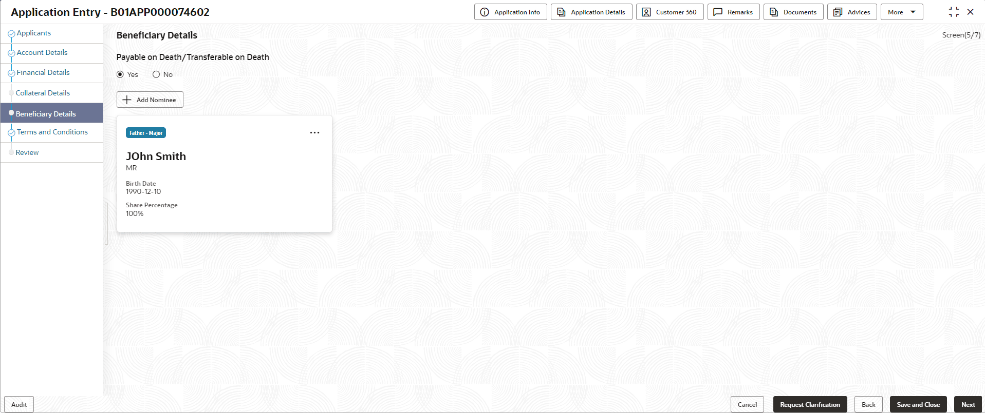

The Beneficiary Details is a non-mandatory data segment. If required, It allows capturing multiple nominees for the account. Beneficiary can be a minor, in that case, it is mandatory to provide details of the guardian. For SMB Customer, Beneficiary Details are allowed only for Proprietary type of Business Accounts.
To add beneficiary details:
- Click Next in from the previous data segment to proceed with the next
data segment, after successfully capturing the data.The Beneficiary Details screen displays.
- Specify the fields on
Beneficiary Detailsscreen.
Table 2-6 Details - Field Description
Field Description Title Select the title of the applicant. First Name Specify the first name of the applicant. Middle Name Specify the middle name of the applicant. Last Name Specify the last name of the applicant. Relationship Type Select the relationship type of the beneficiary with the applicant.
Date of Birth Select the applicant's date of birth. Minor Select to indicate if nominee is minor. Add Guardian Click the Add Guardian link to add the guardian details.
The link appears if the Minor field is enabled.
This field is conditional mandatory.Percentage Specify the percentage to be considered for distribution of the account balance in case of uneventful death of the applicant. Address This section displays the added address of the applicant. It is mandatory to add communication address of the applicant.

Preferred Select to indicate if the given email ID is the preferred ID. Action You can edit or delete the added email details. Add Beneficiary Click to add additional nominee for the account. - Click Next to navigate to the next data segment, after successfully capturing the data. The system will validate all mandatory data segments and data fields. If mandatory details are not provided, the system displays an error message for the user to take action. User will not be able to proceed to the next data segment, without capturing the mandatory data.
