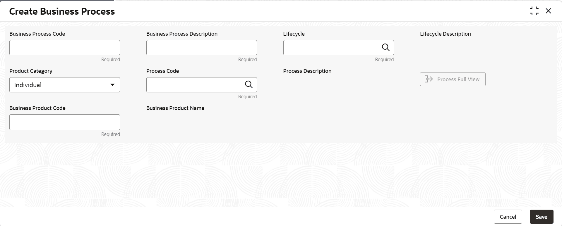

    The Create Business Process screen displays.
    Figure 1-14 Create Business Process
  3. Specify the fields on Create Business Process screen.
    The fields, which mentioned as Required, are mandatory.
    For more information, refer to the fields description table below.
    Table 1-14 Create Business Process – Field Description
    Field Description
    Business Process Code
    Specify an alphanumeric business process code.
    Maximum Length of this field is 16.
    Business Process Description
    Specify the description of the business process code.
    Maximum Length of this field is 60.
    Lifecycle Search and select the lifecycle code.
    Lifecycle Description Displays the description of the lifecycle selected.
    Product Category
    Select the product category.
    Available options are
    • Individual
    • Small and Medium Business
    If Product Type is selected as Loan Account , the system defaults as Individual in read-only mode.
    Process Code Search and select the process code of the business process flow that needs to be mapped for the lifecycle code and business process code combination.
    Process Description Displays the description of the selected process code.
    Business Product Code Specify the business product code for which the business process is being created. Alternatively, select All, in which case the business process will be applicable to all the business products that are associated with the Lifecycle and Process Code.
    Business Product Name Displays the business product name based on the product code selected.
    Factory Shipped Select the factory shipped
    The available options are:
    • Yes
    • No
    Process Full View Click this button to view all stages and data segments associated with the selected process code.
    System allows user to configure only one business process for a combination of Lifecycle and Business Product Code.
  4. Search and select the Process Code.
    The Create Business Process screen displays with stages.
    Figure 1-15 Create Business Process with stages
  5. Click Save to save the data.
