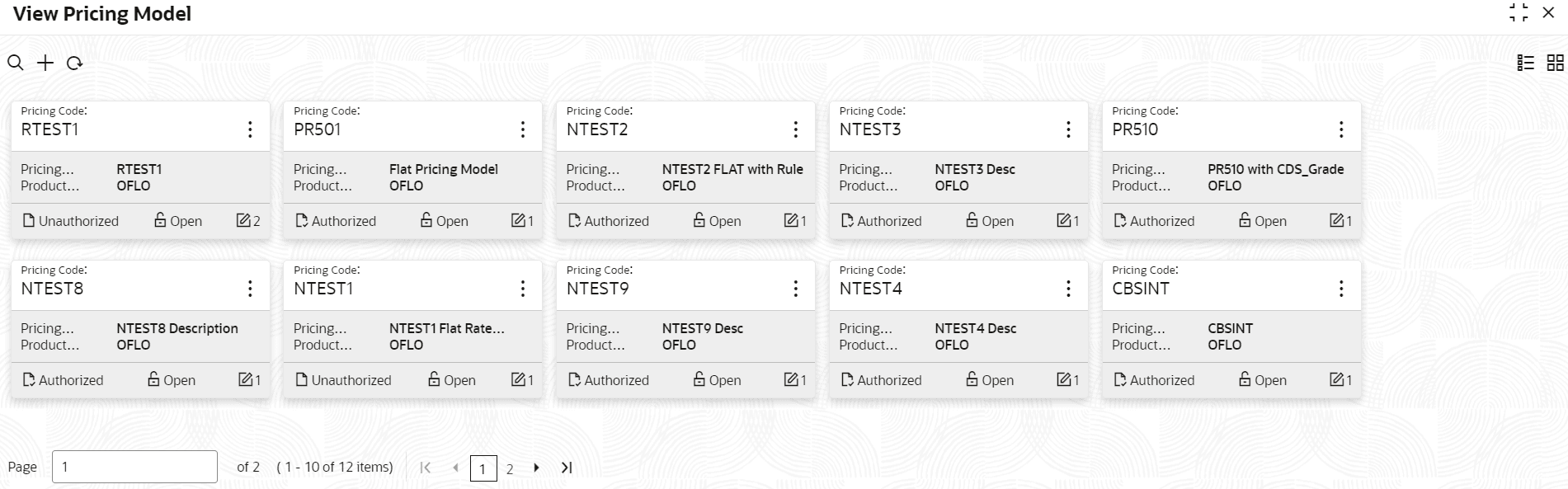

  1. On Homescreen, click Menu, and click Retail Origination, and then click Configurations.
  2. Under Configurations, click Credit Decision, and then click Pricing Model.
  3. Under Pricing Model, click View Pricing Model.
    The View Pricing Model screen displays.
    Table 1-91 View Pricing Model – Field Description
    Field Description
    Pricing Code Displays the pricing code.
    Pricing Description Displays the description of the pricing model.
    Authorization Status Displays the authorization status of the record.
    The available options are:
    • Authorized
    • Rejected
    • Unauthorized
    Record Status Displays the status of the record.
    • Open
    • Closed
    Modification Number Displays the number of modifications performed on the record.

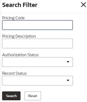

  4. On the View Pricing Model screen, click Search.
    The View Pricing Model - Search screen displays.
    Figure 1-92 View Pricing Model - Search
    Table 1-92 View Pricing Model - Search – Field Description
    Field Description
    Pricing Code Specify the pricing code.
    Pricing Description Specify the description of the pricing model.
    Authorization Status Select the authorization status from the drop-down list.
    • Authorized
    • Rejected
    • Unauthorized
    Record Status Select the record status from the drop-down list.
    • Open
    • Closed
  5. On View Pricing Model screen, click Actions to unlock, delete, authorize or view the created pricing model.

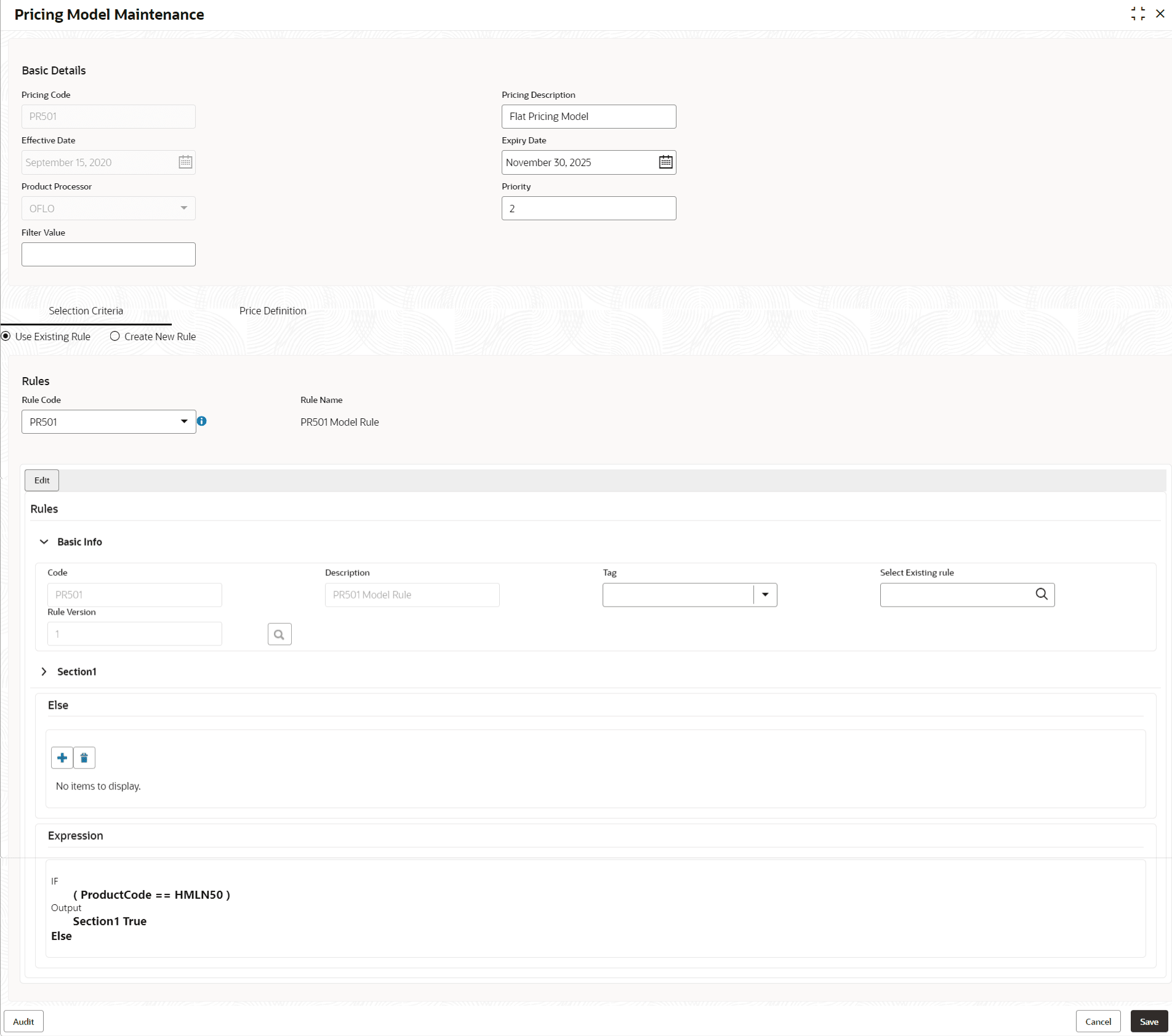

  6. Click Unlock icon to modify the fields.
    The Pricing Model Maintenance - Unlock screen displays.
    Figure 1-93 Pricing Model Maintenance - Unlock
    The fields marked as Required are mandatory.
    Table 1-93 Pricing Model Maintenance - Unlock - Field Description
    Field Description
    Pricing Code Displays the pricing code for the created quantitative pricing model.
    Pricing Description Specify the pricing description for the created pricing model.
    Effective Date Specify the effective date for the created pricing model.
    Expiry Date Specify the expiry date for the created pricing model.
    Product Processor Displays the product processor for the created pricing model.
    Priority Specify the priority of the created pricing model.
    Use Existing Rule
    Specify the existing rule if linked.
    Rule Code
    Specify the rule code for the created pricing model.
    Info
    Click this icon to get the information about the rule.
    Rule Name Displays the rule name.
    Create New Rule Specify the new rule linked to the pricing model.
    Code Specify the new rule code for the created pricing model.
    Description Specify the rule description for the created pricing model.
    + icon Click this icon can add new expression.
    Fact / Rules Displays the fact or rule of the created pricing model.
    Operator Displays the comparison operator of the created pricing model.
    Data Type Displays the data type for the fact or rule for the created pricing model.
    Output Displays the output for the created pricing model.
    Expression Displays the expression updated in the expression builder for the created pricing model.
    Pricing Definition The below listed fields appear in Pricing Definition tab.
    Minimum Rate Specify the minimum rate applicable for the defined pricing model.
    Maximum Rate Specify the maximum rate applicable for the defined pricing model.
    Rate Type
    Select the range type for the created pricing model from the drop-down list.
    • Flat
    • Tiered
    Rate% Specify the interest rate application for the defined pricing.
    Note:This field appears once the user select the Rate Type option as Flat and Link a Rule? option as Yes.
    Rule Select the rule for the defined pricing.
    Note: This field appears once the user select the Rate Type option as Flat and Link a Rule? option as Yes.
    <Numeric Feature> From Specify the minimum numeric value of feature to which the interest rate is applicable.
    This field displays if the Rate Type is selected as Tiered.
    <Numeric Feature> To Specify the maximum numeric value of feature to which the interest rate is applicable.
    Note:This field displays if the Rate Type is selected as Tiered.
    <Character Feature> Value Specify the alphabetic value for which the interest rate is applicable.
    Rate% Specify the interest rate applicable for the defined tier.
    Note:This field appears once you select the Rate Type option as Tiered and Link a Rule? option as No.
    Rule Select the rule for the defined tier.
    Note:This field appears once the user select the Rate Type option as Tiered and Link a Rule? option as Yes.
  7. Click Save to update the modified fields.
