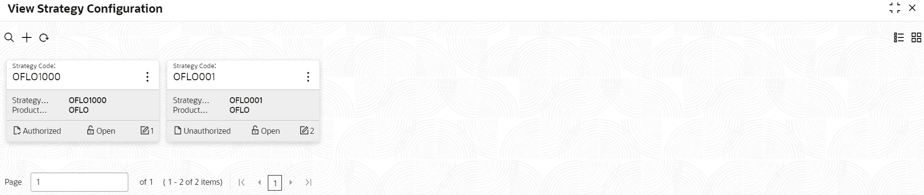

    The View Strategy Configuration screen displays.
    Figure 1-95 View Strategy Configuration
    Table 1-95 View Strategy Configuration - Field Description
    Field Description
    Strategy Code Displays the strategy code.
    Strategy Description Displays the description of the strategy.
    Product Processor Displays the product processor of the strategy.
    Authorization Status Displays the authorization status of the record.
    The available options are:
    • Authorized
    • Rejected
    • Unauthorized
    Record Status Displays the status of the record.
    • Open
    • Closed
    Modification Number Displays the number of modification performed on the record.

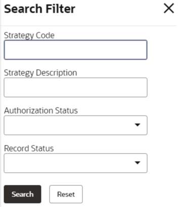

  4. On the View Strategy Configuration screen, click Search.
    The View Strategy Configuration - Search screen displays.
    Figure 1-96 View Strategy Configuration - Search
    Table 1-96 View Strategy Configuration - Search – Field Description
    Field Description
    Strategy Code Specify the strategy code.
    Strategy Description Specify the description of the strategy.
    Authorization Status Select the authorization status from the drop-down list.
    • Authorized
    • Rejected
    • Unauthorized
    Record Status Select the record status from the drop-down list.
    • Open
    • Closed
  5. Click Search.

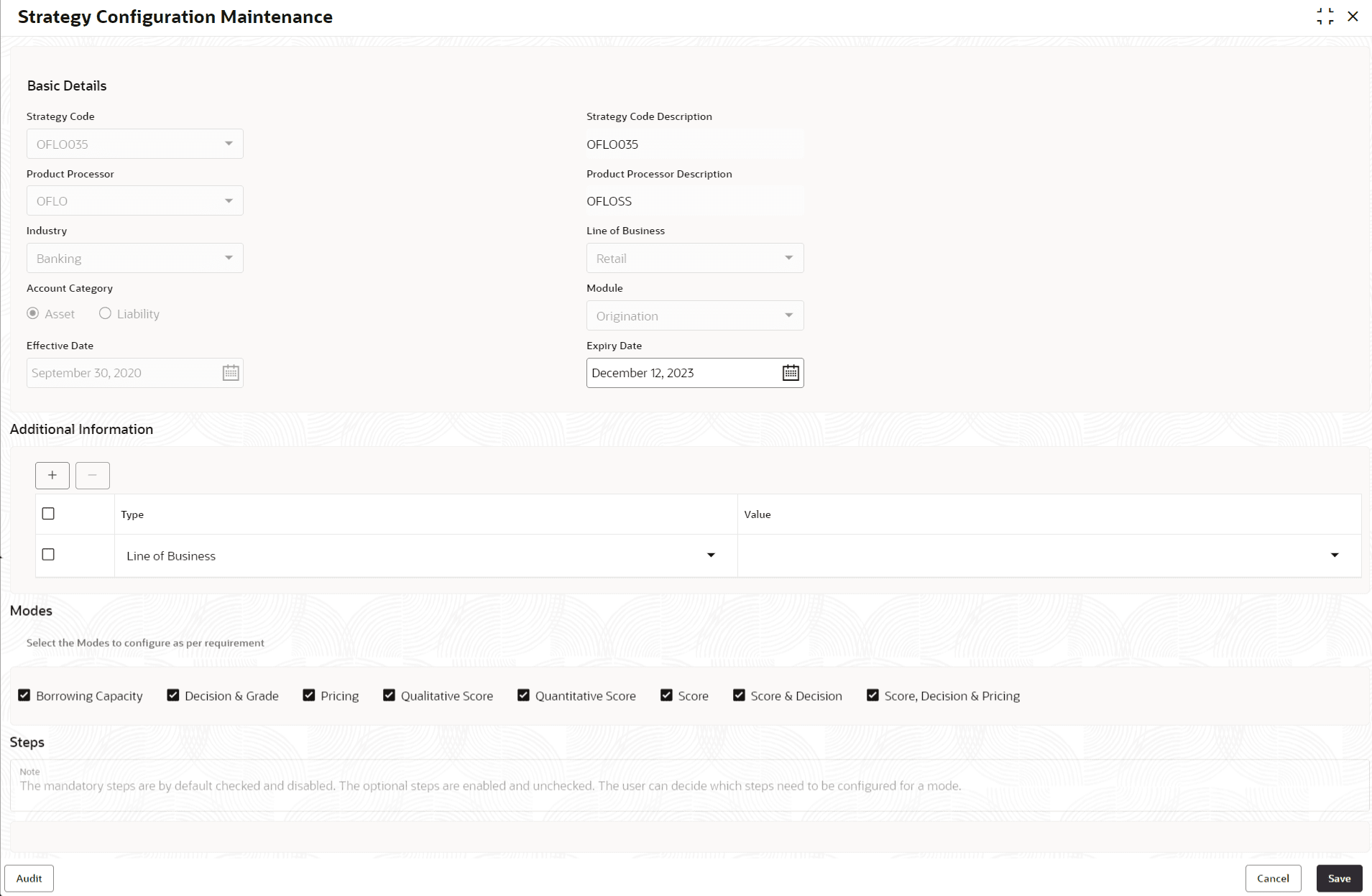

  8. Click Unlock icon to modify the fields.
    The Strategy Configuration Maintenance - Unlock screen displays.
    Figure 1-97 Strategy Configuration Maintenance - Unlock
    Table 1-97 Strategy Configuration Maintenance - Unlock - Field Description
    Field Description
    Strategy Code Displays the created strategy code.
    Strategy Code Description Displays the created strategy code description.
    Product Processor Displays the product processor for the created strategy configuration.
    Product Processor Description Displays the product processor description for the created strategy configuration.
    Account Category Displays the account category for the created strategy configuration.
    Module Displays the module for the created strategy configuration.
    Effective Date Displays the effective date for the created strategy configuration.
    Expiry Date Select the expiry date for the created strategy configuration.
    Type Displays the fact type for the created strategy configuration.
    Value Displays the fact value for the created strategy configuration.
    Steps Specify the steps defined for the created strategy configuration.
  9. Click Save to update the modified fields.
