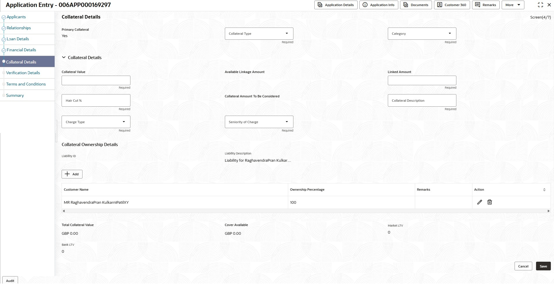

  2. Click Add Collateral to capture the collateral details.
    The Collateral Details screen displays.
If the Collateral Type is selected as Term Deposit, the warning message displays when the OD Limit expiry date is more than the Maturity Date of the term deposit.
  1. Specify the details in the relevant data fields.
    For more information on fields, refer to the field description table below.
    The fields which are marked as Required are mandatory.

    Collateral Details In this section, user can capture the collateral details. Based on the collateral type, the below fields are dynamically appears.
    Term Deposit Number
    Select the Term Deposit Number from the list.
    The Term Deposit which has crossed the maturity date and the Allow Collateral Linkage disabled, will not appear in the list. This field appears only if the collateral type is Deposits.
    Maturity Date Select the Maturity Date of the term deposit.
    Purchase Property
    Specify whether the collateral property being added is being purchased.
    This field appears only if the collateral type is Property.
    Collateral Value Specify the collateral value.
    Estimated Market Value Specify the estimated market value for reusing existing collateral for a new loan. This is the current realizable market value of the collateral, which already exists.
    This field appears only when an existing collateral is reused.
    Available Linkage Amount Displays the available linkage amount.
    During reuse, the system recalculates as Original available linkage amount + Appreciation (if any). If Estimated Market Value ≤ Original Collateral Value, no appreciation is applied.
    Linked Amount Specify the linked amount.
    Guarantee Type
    Select the type of guarantee from the drop-down list.
    This field appears only if the collateral type is Guarantee.
    Hair Cut % Specify the percentage of Hair Cut.
    Collateral Amount To Be Considered
    Displays the collateral amount to be considered.
    Collateral Amount = (Hair Cut % X Collateral Value)
    Mark Collateral For Refinance Specify if an added collateral should be consider for refinance.
    This field appears when the Refinance is enabled.
    Collateral Description Specify the collateral description.
    Charge Type Select the charge type from the drop-down list.
    The available options are:
    • Assignment
    • Hypothecation
    • Lien
    • Pledge
    • Mortgage
    • Registered Mortgage
    • Equitable Mortgage
    The above options displays based on the selected valuation rule as configured on the Origination Preferences screen.
    Seniority of Charge Select the seniority of charge from the drop-down list.
    • Primary
    • Secondary
    • Pari Pasu
    • Pledge
    • Hypothecation
    The above options displays based on the selected charge type as configured on the Origination Preferences screen.
    Applicants This section displays the applicants name and remarks that are involved in the loan application. These applicants are also related to the added collateral.
    Guarantor This section displays the guarantor name.
    Property Location
    In this section, user can enter property address which is added as collateral. This section appears only if user select Property from the Collateral Type list.
    Address
    Specify the address to search already captured address.
    Based on configuration, on entering few letters, the system fetches the related address that are already captured.
    Based on the selection, the fields are auto populated in the address section.
    Address Line 1 Specify the building name.
    Address Line 2 Specify the street name.
    Address Line 3 Specify the city or town name.
    Country Select and search the country code.
    State/Country Sub Division Specify the state or country sub division.
    Zip Code/Post Code Specify the zip or post code of the address.
    Collateral Ownership Details
    In this section, specify the ownership details of the collateral. This section displays all the customers that are involved in the loan application.
    Liability ID Displays the Liability ID.
    Liability Description Displays the Liability description.
    Add Click this button to add the collateral ownership details.
    Customer Name
    By default, displays the primary customer name. User can add more customer name to include ownership percentage.
    Select the customer name from drop-down list if multiple applicants associated with application.
    Ownership Percentage
    By default, displays the percentage of the ownership of the primary customer. Specify the ownership percentage if multiple applicants associated with application.
    Remark
    Specify the remark of the customer.
    Action Perform one of the following actions:
    • Click Editto edit the saved ownership details.
    • Click Deleteto delete the saved ownership details.
    • Click save record to save the added ownership details.
    • Click cancel to cancel the added ownership details.
    Total Collateral Value Displays the total value of collateral.
    This field will be auto updated based on the number of collaterals.
    Cover Available
    Displays the cover available.
    Market LTV Displays the market loan-to-value.
    Bank LTV Displays the bank loan-to-value.
    All the fields are fetched from Oracle Banking Credit Facilities Process Management in read only mode, if integrated with Oracle Banking Credit Facilities Process Management.

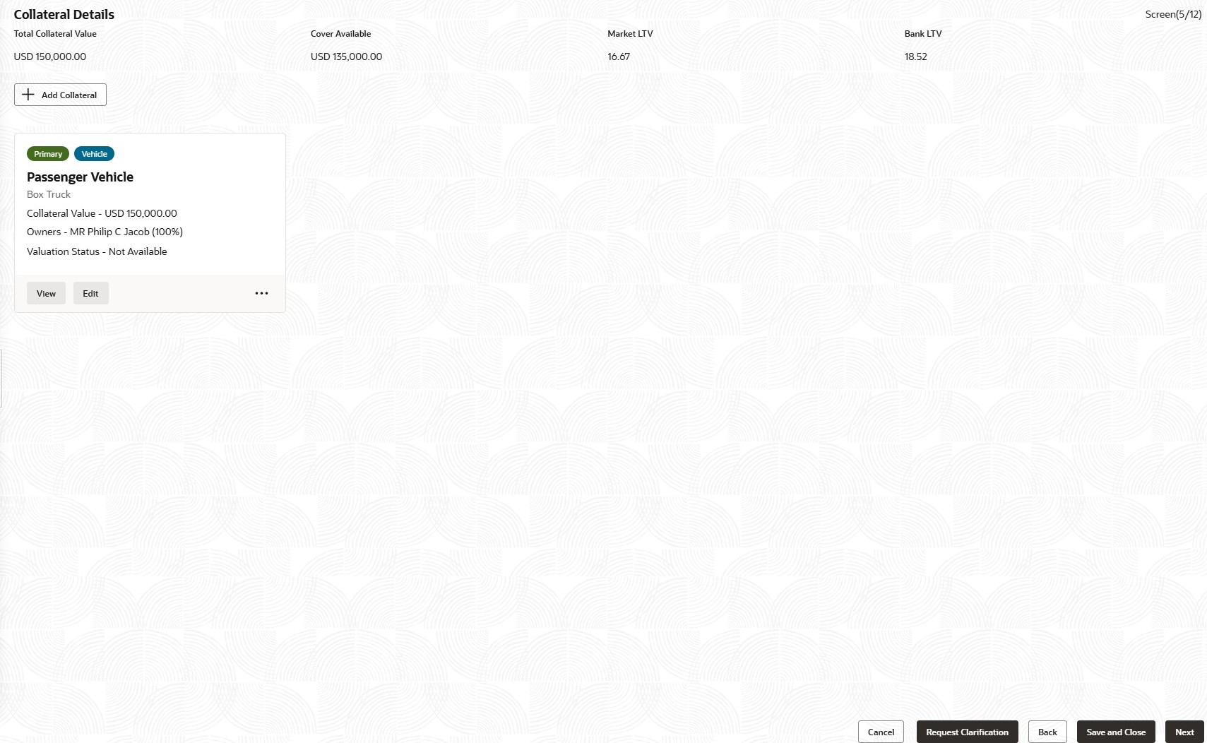

    Create a new tile with the collateral summary on the Collateral Details screen. On saving the collateral details, the system runs the valuation rule maintained on the Origination Preferences screen.
    Figure 3-19 Collateral Details Tile
  3. On the collateral summary tile, perform the following valuation actions by clicking action button.

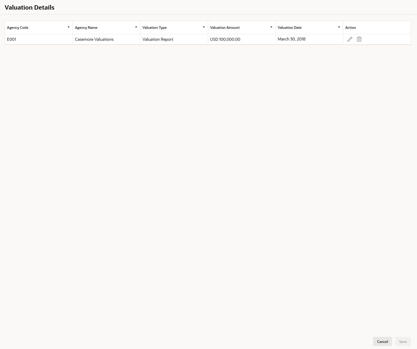

    Figure 3-20 Valuation Details - View (External)
    Figure 3-21 Valuation Details - Capture
    Figure 3-22 Valuation Details - View (Manual)
    Table 3-14 Valuation Details
    Field Description
    Add Click this button to add the valuation details manually.
    Valuation Type Select the type of valuation from the drop-down list.
    Valuation Amount Specify the valuation amount.
    Agency Code Select the valuation agency code from the drop-down list.
    Agency Name Display the valuation agency name for selected valuation agency code,
    Valuation Date Select the valuation date.
