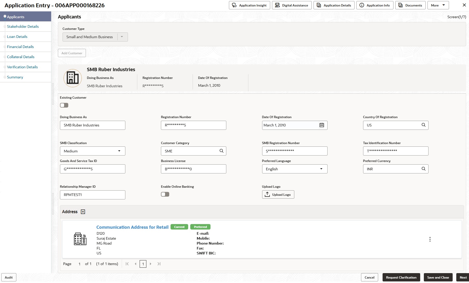

To capture applicants details
  1. In the Current Application Entry stage, update the customer details in the Applicants data segment based on the respective customer type.
    The Applicants - Small and Medium Business (SMB) screen displays.
    Figure 3-6 Applicants - Small and Medium Business
  2. Specify the details in the relevant data fields. For more information on fields, refer to the field description table below.
    Table 3-3 Small and Medium Business – Field Description
    Field Description

    Upload Logo Click Upload Logo button to upload the logo for the business.
    Address
    This section displays the added address of the applicant. It is mandatory to add communication address of the applicant.
    Click Add to add address details.
