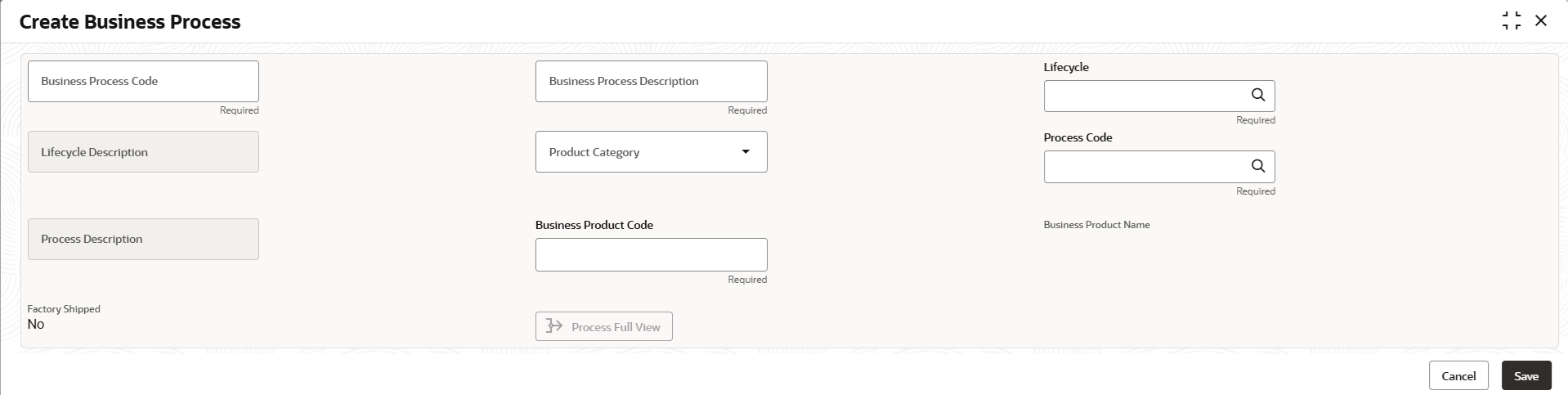

  1. On Homescreen, click Menu, and click Retail Origination, and then click Configurations.
  2. Under Configurations, click Business Process and click Create Business Process.
    The Create Business Process screen displays.
    Figure 1-14 Create Business Process
  3. Specify the fields on Create Business Process screen.
    The fields marked as Required are mandatory.
    For more information, refer to the fields description table below.

  4. Search and select the Process Code.

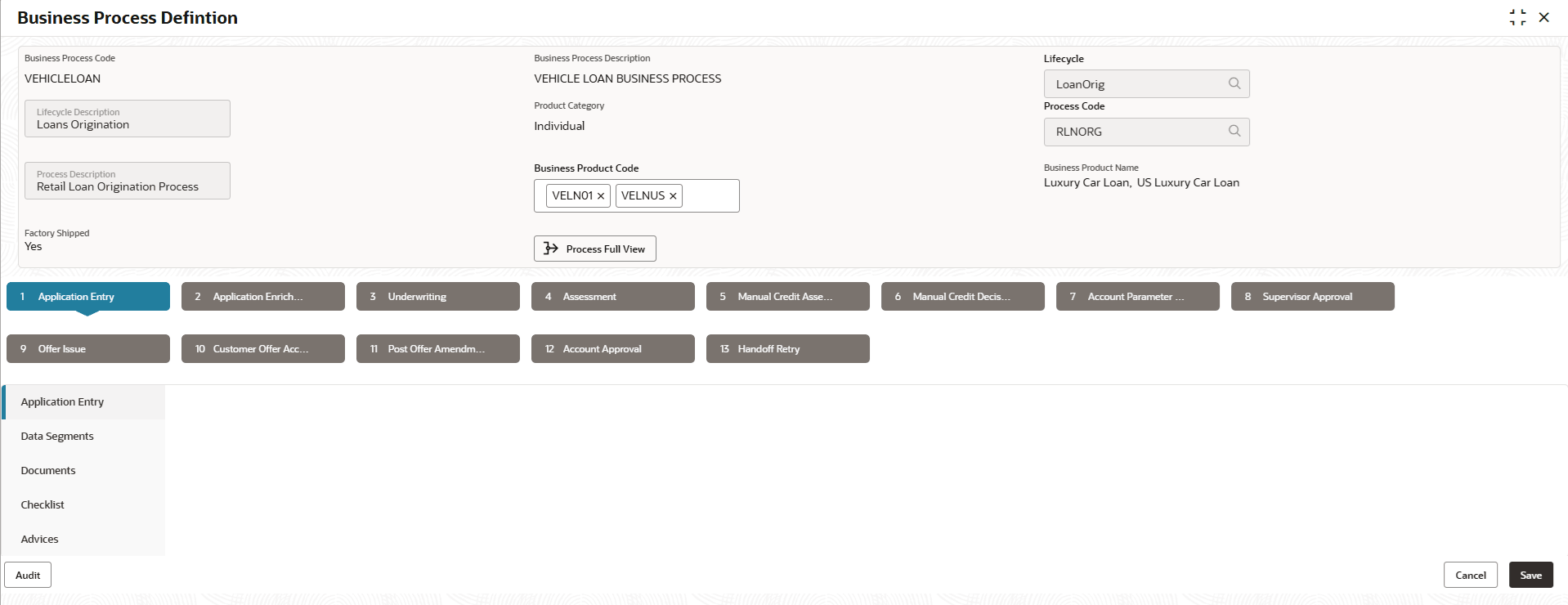

    The Create Business Process screen displays with stages.
    Figure 1-15 Create Business Process with stages
  5. Click Save to save the data.
