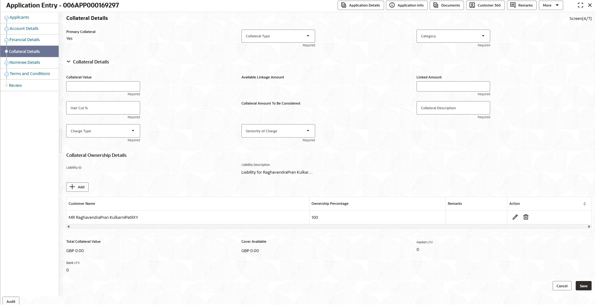

  2. Click Add Collateral to capture the collateral details.
    The Collateral Details screen displays.

  4. Specify the details in the relevant data fields.
    For more information on fields, refer to the field description table below.
    The fields which are marked as Required are mandatory.

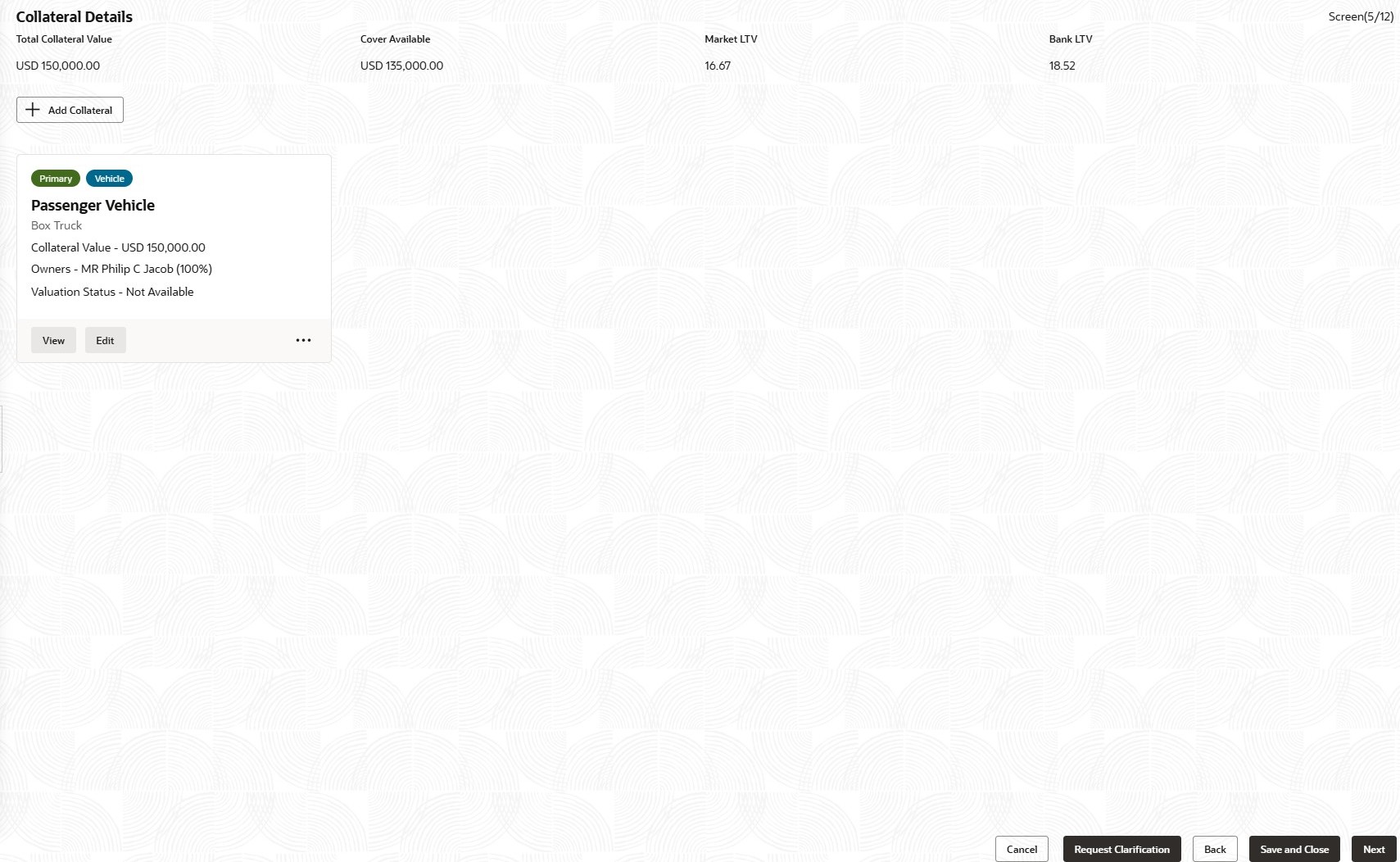

    Create a new tile with the collateral summary on the Collateral Details screen. On saving the collateral details, the system runs the valuation rule maintained on the Origination Preferences screen.
    Figure 2-13 Collateral Details Tile
