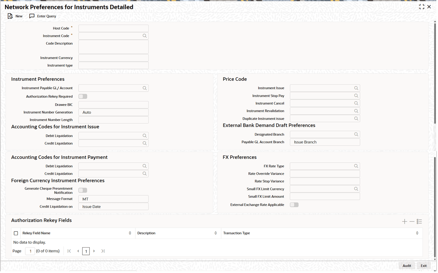

  1. On Homepage, specify PIDINPRF in the text box, and click next arrow.
    Network Preferences for Instrument Detailed screen is displayed.
    Figure 2-5 Network Preferences for Instrument Detailed
    Description of Figure 2-5 follows
    Description of "Figure 2-5 Network Preferences for Instrument Detailed"
  2. On Network Preferences for Instrument Detailed screen, click New to specify the fields.
