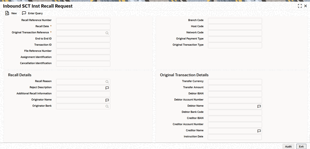

1.6.2 Inbound SCT Inst Recall Request
Use Inbound SCT Inst Recall Request screen to view inbound recall requests received for transactions.
  1. On Homepage, specify PFDINRCL in the text box, and click next arrow.
    Inbound SCT Inst Recall Request screen is displayed.
    Figure 1-31 Inbound SCT Inst Recall Request
    Description of Figure 1-31 follows
    Description of "Figure 1-31 Inbound SCT Inst Recall Request"
  2. On Inbound SCT Inst Recall Request screen, click New to specify the fields.
    For more information about the fields, refer to field description below:
    Table 1-15 Inbound SCT Inst Recall Request - Field Description
    Field Description
    Recall Reference Number System defaults the Recall Reference Number.
    Recall Date System displays date on which the recall was initiated. This date is defaulted as recall booking date.
    Original Transaction Reference Select the Original Payment Reference from the list of values.
    End to End Identification System defaults the End to End Identification on Original Transaction Reference selected.
    Transaction ID Specify the Transaction ID.
    File Reference Number System defaults the File Reference Number on Original Transaction Reference selected.
    Assignment Identification Specify the Assignment Identification.
    Cancellation Identification Specify the Cancellation Identification.
    Branch Code System defaults the Branch Code on clicking New button.
    Host Code System defaults the Host Code on clicking New button.
    Network Code System defaults the Network Code on Original Transaction Reference selected.
    Original Payment Type System defaults the Branch Code on clicking New button.
    Original Transaction Type System defaults the Branch Code on clicking New button.
    Recall Details This section displays the Recall Details.
    Recall Reason While initiating a Recall request, you can specify the Reason for the Recall from the list of values. All valid reject codes applicable for the Network for the operation ‘Payment Recall ‘are listed.
    Reject Description Reason Description is defaulted based on the Recall Reason selected.
    Additional Recall Information If the reason code entered is FRAD then you can specify additional details.
    Originator Name Specify the Name of the Originator.
    Originator Bank
    Specify the name of the Originator Bank from the list of values.
    Note: Either Originator Name or Originator Bank Code can be captured as part of recall request. For Network Type Code corresponding to TIPS, only the BICs in the TIPS Directory are displayed.
    Original Transaction Details This section displays the Original Transaction Details.
    Transfer Currency System defaults the Transfer Currency on Original Transaction Reference selected.
    Transfer Amount System defaults the Transfer Amount on Original Transaction Reference selected.
    Debtor IBAN System defaults the Debtor IBAN on Original Transaction Reference selected.
    Debtor Account Number System defaults the Debtor Account Number based on selected Original Transaction Reference.
    Debtor Name System defaults the Debtor Name on Original Transaction Reference selected.
    Debtor Bank Code System defaults the Debtor Bank Code based on selected Original Transaction Reference.
    Creditor IBAN System defaults the Creditor IBAN on Original Transaction Reference selected.
    Creditor Account Number System defaults the Creditor Account Number based on selected Original Transaction Reference.
    Creditor Name System defaults the Creditor Name on Original Transaction Reference selected.
    Instruction Date System defaults the Instruction Date on Original Transaction Reference selected.
