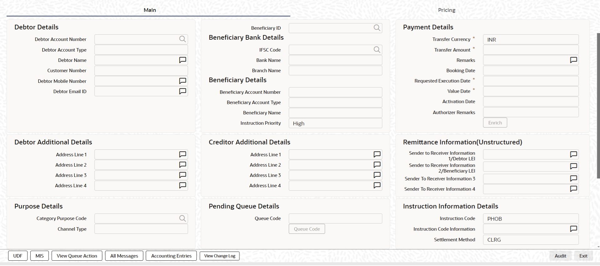

2.1.1.1 Main Tab
This topic explains the Main tab of the RTGS Outbound Payment Input Detailed screen.
  1. On the RTGS Outbound Payment Input Detailed screen, select the Main Tab.
    The Main details are displayed.
    Figure 2-2 RTGS Outbound Payment Input Detailed - Main Tab
    Description of Figure 2-2 follows
    Description of "Figure 2-2 RTGS Outbound Payment Input Detailed - Main Tab"
  2. On Main Tab, specify the fields.
    Table 2-2 RTGS Outbound Payment Input Detailed_Main Tab - Field Description
