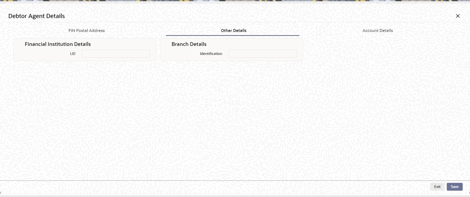

    Figure 3-53 Main Tab_Debtor Agent Details - Other Details
    Description of Figure 3-53 follows
    Description of "Figure 3-53 Main Tab_Debtor Agent Details - Other Details"
  4. On the Other Details tab, specify the fields.
    Table 3-52 Main Tab - Debtor Agent Details Button - Other Details Tab - Field Description
    Field Description
    Financial Institution Details This section displays the following fields.
    LEI Specify LEI of the agent.
    Branch Details This section displays the following fields.
    Identification Specify the identification of the branch.
