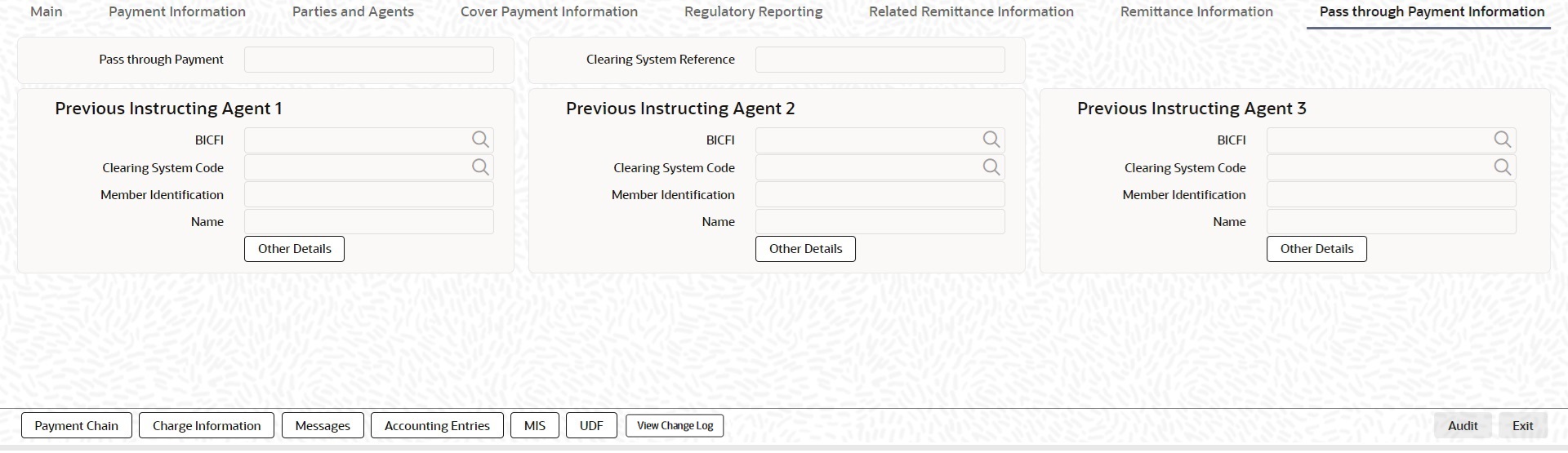

  1. From the main screen, select the Pass through Payment Information tab.
    The Pass through Payment Information details are displayed.
    Figure 3-31 Cross Border Outbound FI to FI Customer Credit Transfer Input - Pass through Payment Information Tab
    Description of Figure 3-31 follows
    Description of "Figure 3-31 Cross Border Outbound FI to FI Customer Credit Transfer Input - Pass through Payment Information Tab"
  2. On the Pass through Payment Information, specify the fields.

    Clearing System Reference Specify the Clearing System Reference for the transaction.
    Previous Instructing Agent 1 This section displays the following fields.
    BICFI Select a BICFI code from the list of values.
    Clearing System Code Select the Clearing System Code from the list of values.
    Member Identification Specify the member identification.
    Name Specify the name.
    Other Details Button
    Click the Other Details button on Pass through Payment Information tab under Previous Instructing Agent 1 header to process the sub-screen. This screen shows the Previous Instructing Agent 1.
    For more details, refer to the topic Pass through Payment Information Tab - Other Details Button.
    Previous Instructing Agent 2 This section displays the following fields.
    Click the Other Details button on Pass through Payment Information tab under Previous Instructing Agent 2 header to process the sub-screen. This screen shows the Previous Instructing Agent 2.
    Previous Instructing Agent 3 This section displays the following fields.
    Click the Other Details button on Pass through Payment Information tab under Previous Instructing Agent 3 header to process the sub-screen. This screen shows the Previous Instructing Agent 3.
