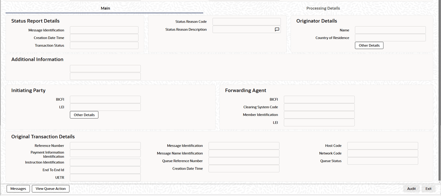

Navigate to the main screen Inbound Customer Payment Status Report View
  1. Click the Main Tab on the Inbound Customer Payment Status Report View Detailed screen.
    Main Tab sub-screen is displayed.
    Figure 21-2 Inbound Customer Payment Status Report View Detailed - Main Tab
    Description of Figure 21-2 follows
    Description of "Figure 21-2 Inbound Customer Payment Status Report View Detailed - Main Tab"
  2. On Main tab sub-screen, specify the fields.
    For more information on fields, refer to the field description below:
    Table 21-2 Inbound Customer Payment Status Report View Detailed - Main Tab - Field Description
    Field Description
