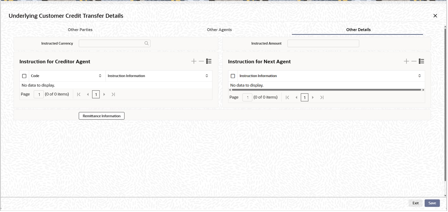

  1. Click the Underlying Customer Credit Transfer button in the main screen and select the Other Details tab.
    The Underlying Customer Credit Transfer Details - Other Details screen is displayed.
    Figure 4-155 Underlying Customer Credit Transfer - Other Details
    Description of Figure 4-155 follows
    Description of "Figure 4-155 Underlying Customer Credit Transfer - Other Details"
  2. On the Other Details tab of the Underlying Customer Credit Transfer Details, specify the fields.

    Instructed Currency Select the Instructed Currency from the list of values.
    Instructed Amount Specify the Instructed Amount.
    Instruction for Creditor Agent This section displays the Instruction for Creditor Agent details.
    Code
    Select the code from the list of values. The list displays the following values:
    • CHQB
    • HOLD
    • PHOB
    • TELB
    Only two occurrences of Instruction For Creditor Agent are allowed.
    If the code CHQB is present, then the code HOLD is not allowed; Otherwise HOLD is optional.
    If the code PHOB is present, then the code TELB is not allowed; Otherwise TELB is optional.
    Instruction Information Specify the instruction information.
    Instruction for Next Agent This section displays the Instruction for Next Agent details.
    Instruction Information Specify the instruction information to be given to the next agent in the payment chain.
    Note: Only four occurrences of Instruction For Next Agent are allowed.
