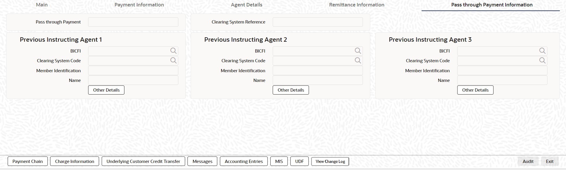

  1. From the main screen, select the Pass through Payment Information tab.
    The Pass through Payment Information details are displayed.
    Figure 3-185 RTGS ISO Outbound FI Credit Transfer Input Detailed - Pass through Payment Information Tab
    Description of Figure 3-185 follows
    Description of "Figure 3-185 RTGS ISO Outbound FI Credit Transfer Input Detailed - Pass through Payment Information Tab"
  2. On the Pass through Payment Information tab, specify the fields.
    Table 3-158 RTGS ISO Outbound FI Credit Transfer Input Detailed_Pass through Payment Information Tab - Field Description
    Field Description
    Pass through Payment Select Yes or No. This field specifies whether the payment is a pass-through payment.
    Clearing System Reference Specify the Clearing System Reference for the transaction.
    Previous Instructing Agent 1 This section displays the following fields.
    BICFI Select a BICFI code from the list of values.
    Clearing System Code Select the Clearing System Code from the list of values.
    Member Identification Specify the member identification.
    Name Specify the name.
    Other Details Button
    Click the Other Details button on Pass through Payment Information tab under Previous Instructing Agent 1 header to open the sub-screen. This screen shows the Previous Instructing Agent 1.
    Refer to the topic Process Agent Details Tab - Other Details Button for details of fields and sub-screen of the Other Details button.
    Previous Instructing Agent 2 This section displays the following fields.
    Click the Other Details button on Pass through Payment Information tab under Previous Instructing Agent 2 header to open the sub-screen. This screen shows the Previous Instructing Agent 2.
    Refer to the Section Process Agent Details Tab - Other Details Button for details of fields and sub-screen of the Other Details button.
    Previous Instructing Agent 3 This section displays the following fields.
    Clearing System Code Specify Clearing System Code from the list of values.
    Click the Other Details button on Pass through Payment Information tab under Previous Instructing Agent 3 header to process the sub-screen. This screen shows the Previous Instructing Agent 3.
