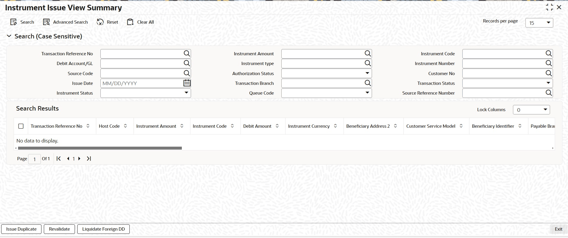

1.2.2.12 Instrument Issue View Summary
- On Homepage, specify PISINSVW in the text box, and click next
arrow.Instrument Issue View Summary screen is displayed.
- Search using one or more of the following parameters:
- Transaction Reference Number
- Instrument Amount
- Instrument Code
- Debit Account/GL
- Instrument Type
- Instrument Number
- Source Code
- Authorization Status
- Customer No
- Issue Date
- Transaction Status
- Queue Code
- Source Reference Number
- Once you specified the parameters, click the Search button.System displays the records that match the search criteria.
- Double click a record or click the Details button after selecting a record to view the detailed screen.
- You can perform the following actions:
